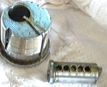

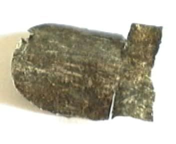

You say you can still turn the plug even with the shim stuck? Try rotating the plug back and forth while pulling on the shim to loosen it up.
You might try to give the lock a good shot of WD40 or silicon lube or something like this. This might help to get the stuck shim back out. Slight taps with something heavy might help to loosen up the stuck plug.

Image Image Image Image Image

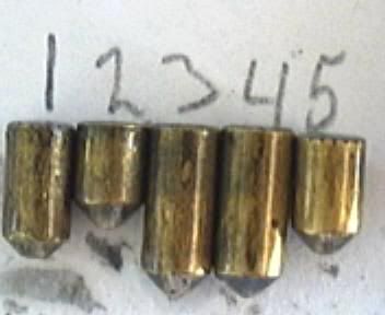

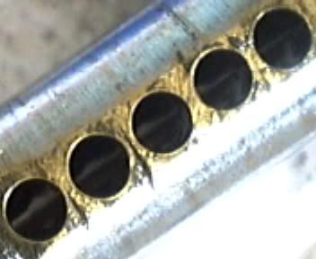

I gave the lock some loctite super lube, turned the plug with a plier, and was lucky to get the piece out whole.
The pins are HUGE the longest ones are 8x4 mm :shock:
Look how the pinholes are lined up, that is pretty straight :shock:
:D
p1ckf1sh, I just saw your post, before I hit submit, thanx it worked!

Postby Blink » 15 Jun 2006 12:54
Congrats on getting the shim out, and the lock torn apart!
That pinning looks really ugly! Med, High, Low, Low, High, it could be a good practice lock if you could keep it ;).

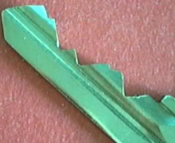

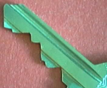

Postby Wrenchman » 19 Jun 2006 12:08
Here is the Key for the La Fonte, and pin 3 & 4 are, IMO, quite deep, but did I reach the bottom for makeing a bump key?
