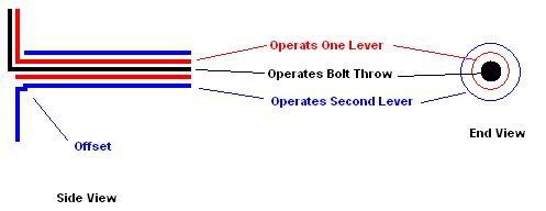

Has anyone ever seen a 3 in 1 pick for Italian lever locks? I mean a coaxial pick with two sleeves around an inner rod with three bits at the end, one for each "axle"? You would tension the bolt with the middle sleeve and manipulate the back and front levers with the inner rod and outer sleeve.

Postby cbuk2k » 4 Sep 2006 9:00
I don’t think that a three in one pick would be strong enough; you would have to produce a cross between a curtain pick and a two in one. As the external diameter of the pick is fixed (to fit in the key way) increasing the number of sleeves/tubes means decreasing the wall thickness. The bolt thrower needs to be fairly sturdy so this limits it further.
To get a decent quality weld you’d probably be better off starting with a round section welding the bit in place and boring it out. I have had a couple of attempts to weld something really thin and it’s not easy. The second bit for manipulating the levers would also have to be offset to reach the furthest back lever. Belo is a badly drawn pic of what I’m saying.

Postby greyman » 4 Sep 2006 9:24
cbuk2k, that is a nice picture. You are probably right about the strength of materials. The Italian lever locks have quite strong springs on the tumblers, so to hold the levers in a picked position would require quite a bit of tension on the bolt. Perhaps it is easier to make a tensioning tool and pick the levers manually, then you could apply the required tension. The other problem I see is that many of these locks require two turns of the key with the bolt having to pass through 4 separate gates. If picking it once sounds hard, then picking it 4 times in a row sounds a lot worse :(
