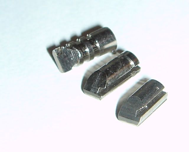

Postby linty » 26 Aug 2006 16:18
those are the two kinds of serrated pins with a normal one for reference. A large number of the pins we have are serrated, seems like the majority.
also, i took a picture of the pins with the gates lined up (roughly) to give an idea of how the pins would be sitting when the correct key was in the lock. Hopefully this will help show why the spacing between cuts on a biaxial key can vary. the space between the 2nd and 3rd would be quite small and between the third and fourth quite wide.
the pins are: aft-center, aft-right, fore-center, aft-center, aft-left.

Postby globallockytoo » 26 Aug 2006 16:27
Thanks for the great pics.....I'd never seen them before and it opened my eyes a little....
I think I understand why and how they are able to be picked, with some difficulty though.
Thanks again for the great pics
