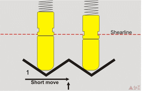

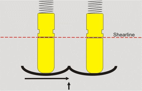

As for bumping, I edited in paint your original picture to show what I am thinking of.
I suck at paint, but you should get the idea.
I think this should be the real bumpkey.

2 Libris
I do not think that this key it will work,too long a motion
and standart bumpkey cutting I think it will give the necessary result

Postby greyman » 28 Feb 2007 16:05
pickmeister - I like your animated images! :)
However I'm not sure that the sawtooth one is an accurate representation of how a bump key works. The lower pin would not go down before the top pin, which has the additional spring tension to force it down. Bumping works by transfer of energy via the pins - the bottom pin transfers it straight to the top pin, which moves up in response against the tension of the driver spring.
