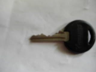

raimundo wrote:I have seen the key and it has a very long pin near the center, other than this I think its a typical chinese laminated security pin type padlock.
I have a picture of the key. But as for the security pins the website says it has mushroom security pins. http://www.chateauproducts.com/index.php?main_page=product_info&products_id=5833
Here is the picture:

anyone have a chateau that dosent have long pins at the middle or front? I think that this lock company has chosen one of the effective anti picking profiles, even medeco decided to do that to their keys, you won't find one without a deep cut with short pins behind it.

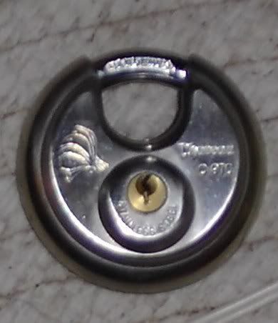

Postby tecnovist » 12 Jan 2008 10:21
poor paperclip picker ---Hi--- do you have a pic of the Chateau C 970 lock that you can post thanks

Postby poor paperclip picker » 12 Jan 2008 16:58
tecnovist wrote:poor paperclip picker ---Hi--- do you have a pic of the Chateau C 970 lock that you can post thanks
