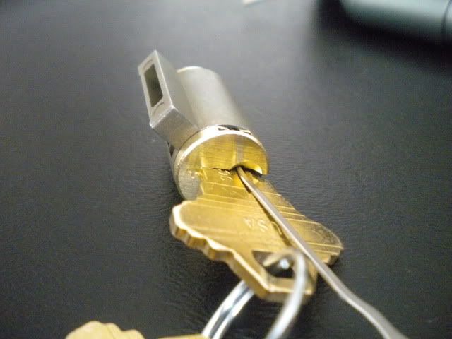

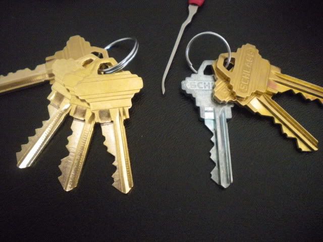

We've already had a customer bring one into our shop to have it keyed to his older house key. I cut a dupe, milled it down and rekeyed it. We quoted and charged a little more than a standard rekey. We probably could have charged more than we did as I doubt he could have gotten that done anywhere else at this time. Oh well :roll: , maybe next time.
globallockytoo wrote:Aside from this, once picked to the 11 o'clock position, what is to stop you from pushing the tab apart with a tool? so you can then rekey it?
Nothing. It's a piece of cake at that point.

I can't answer why there aren't any locksmiths like me in your area. It's possible there is, but finding them (him?) could be hard to do. Of course the only reason we were able to do the job was because I bought one of the locks myself so I could figure it out... And yes I used a wire to push in the tab (I believe I used a paperclip 8) ).

Postby FarmerFreak » 10 Jun 2010 19:40
globallockytoo wrote:were you able to actually re-key the lock without the "blue" change key?
Yep, here is a picture of some keys I milled down the first day I got the lock so that I could rekey it. :mrgreen:
At the time I used my Locknewb short hook to hit the tab.
