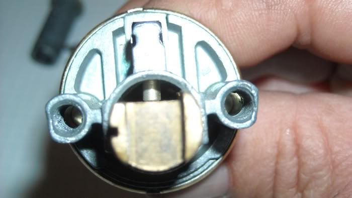

How to disassemble Kwikset? Photo included

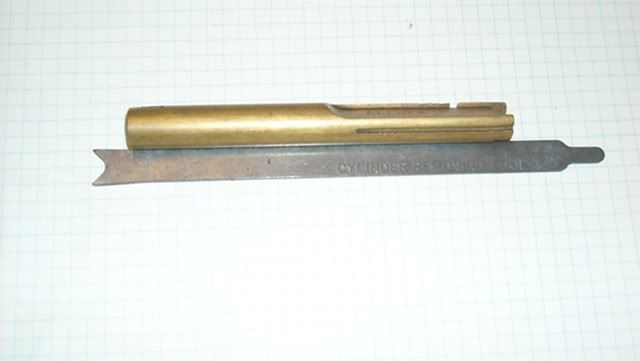

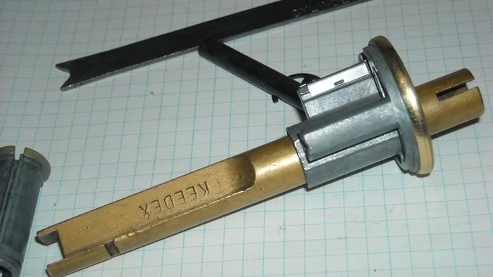

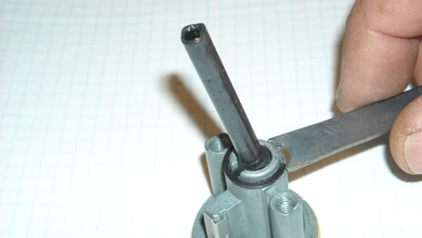

Some pics of what they are talking about:
The Follower and a Kwickset tool
The Kw tool in action
The follower in the plug
The follower in the plug,notice the top pins droped enough to remove any master pins. The master pins will just fall out. Done in a few seconds.
larger pics can be seen here:
Larger photos
