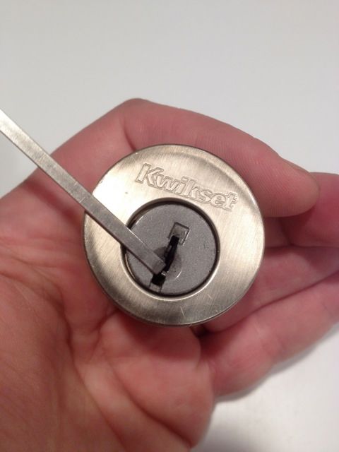

Robotnik,
Would you have a picture of the side-of-keyway method? Are you using a 2 pronged tensioner?

Postby Robotnik » 4 Feb 2015 11:50
crowley wrote:Robotnik,
Tensioner I was using was a standard piece of windshield wiper insert, thinned out and bent 90 degrees. No double prong, just a regular BOK-style tension tool. I'll snap a photo of placement within the keyway when I get a spare second.

Postby Robotnik » 5 Feb 2015 10:02
This is roughly where I positioned the tension tool, though I was using a thinner tool than the one pictured. Was able to pick it to reset like this.
SmartKeys are definitely a bear to pick; I feel your pain. It's just too bad there are so many...alternate...ways to open them; with some better materials and engineering tolerances, these locks could be formidable.
