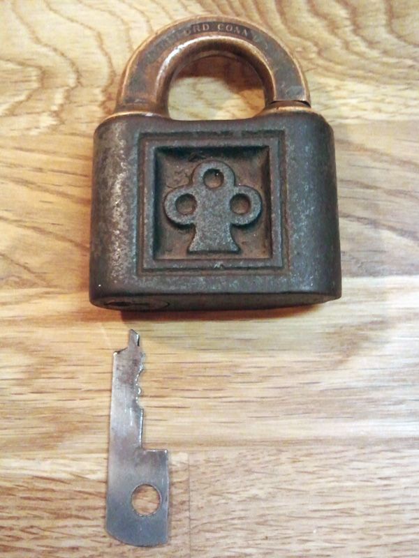

Thanks Gordon for this beautiful padlock. I shimmed it easily but was surprised by the force required to pull the shackle open.
There's no square slot under the shackle hole, so it doesn't look rekeyable like Lauren's one.
I made a blank with a piece of scrap steel I had at home and filed down the tip to go under the fourth pin. Then I prepared the blank for impressioning by marking more or less pins positions and by smoking it with a Bic lighter. I had a hard time trying to see the marks, so I eyeballed the first two pins heights and filed them a little less than needed. At this point they started marking a lot and was able to file them down to the correct height.
I also verified their height by inserting the shim with the key in the lock: it entered easily under them but stopped at the third pin.
I'm not sure if I've filed the third and fourth pin positions too much or if I'm still able to finish this key.
When I was sure there were no more marks I stopped filing and decided to cut the bottom part of the key tip, like both Gordon and Richard did.
I don't understand why you did so, and see that Lauren made a working key without this cut, but since I thought I had a virtually working key I did it too.
Nothing changed, the key doesn't get marked but doesn't open the padlock... I'll try again soon.

About my padlock, based on the fact that the shim didn't go over the second pin when the key was inserted, I filed down a little the third position on the key...
I had to wiggle a little the key to make it work, but now it works! Imagine my surprise when it finally opened the padlock!
Now the shim goes over the third pin but it stops at the fourth: looks like I filed the fourth position too much, so the big pin is not lifted enough and needs a little wiggling on the key.
All I have to do is to prepare another blank and copy this key on it, leaving the fourth cut a little higher. I'll leave all of them a hair taller, so to finish them by impressioning and get a smooth working key.
Now it's time to find a nice piece of steel or brass and make a good looking key.
Re: Key Created for Yale Push Key Padlock
Postby femurat » 21 Dec 2012 6:26

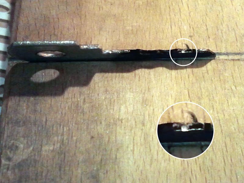

I made a new key for my padlock, started by copying the old one a little higher and slowly filed down each cut while trying to open the padlock.
As you can see in the second picture, the last mark before the lock opened is quite obvious. Unfortunately the other marks were difficult to see, so it was not as easy as one can imagine.
This new key works like a charm. If I find a nice piece of brass I can attempt to make a new key with the trefoil bow :P

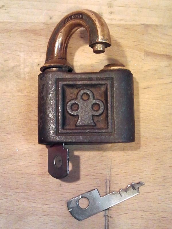

Just finished impressioning another Yale pin tumbler push key. This time, had a commercially made blank, rather than hammering out another blank to fit. :lol: Now you can see a key that I made for one of these locks that looks nice! Did lubricate the lock lightly with some light oil due to some light rust, so that now it functions well.
The key works beautifully.
