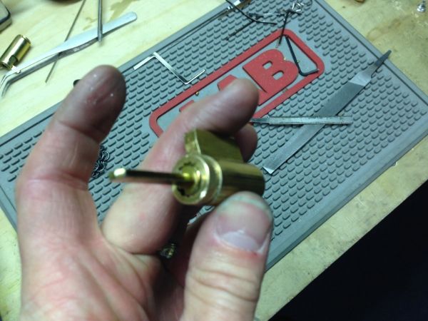

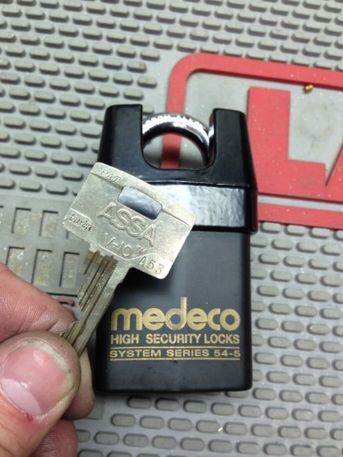

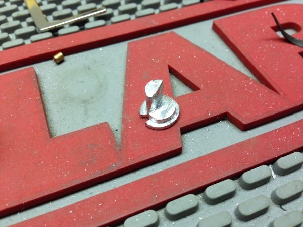

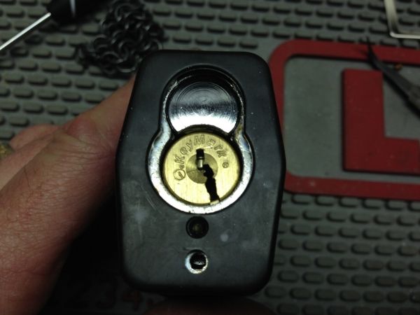

I know this is kind of an old thread, but I wanted to share a little "moding" of my own that I did on a nice Medeco padlock. I got the padlock which has a Keymark cylinder in it, but wanted something a bit more pick resistant.

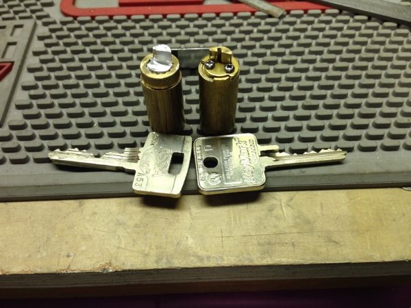

I decided to use an Assa Twin V-10 that I pieced together from ebay purchases.
Only problem was the tailpiece wasn't compatible…

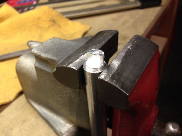

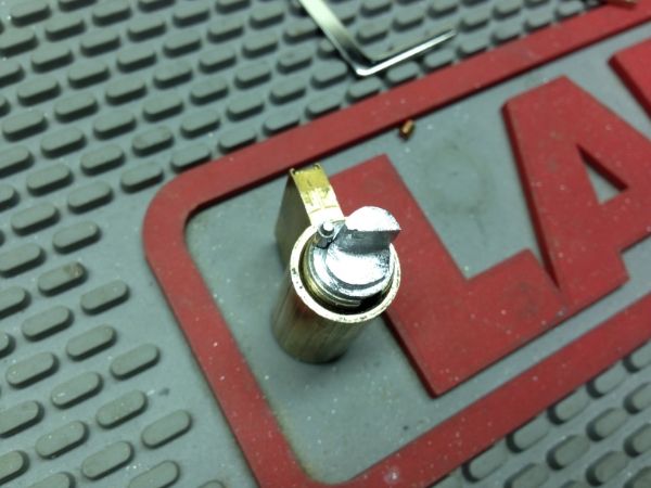

I know that I could probably buy a tail piece pre made and just install it (maybe, not sure), but I had an itch to do something with my own two hands. So I started to shape one of my own out of aluminum rod and a file.
It took a little while, but I got it done in not too long.

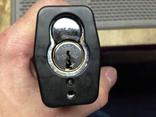

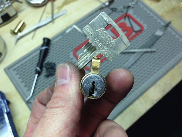

Here is a side-by-side comparison of the two cylinders with the completed tailpiece on the Assa.
Now I have a cool(er) padlock and it has a little touch of my own to it.
Hope you enjoyed seeing that. Would love any feedback. My one concern is that aluminum is a bit soft and I am not real sure it won't warp over time and use. I may have to try and make one out of a stronger metal. Any thoughts?
Thanks for checking it out!

Postby femurat » 3 Dec 2013 3:09
Great job phrygianradar!
While I was reading your post my concern was about aluminium strength too. I think the right term is "metal fatigue". Even if your tailpiece works like a charm, and it can last years, it can eventually break. You may disassemble the padlock and check for wear signs after a few months of use, just to be on the safe side :wink:
And then there's that other thing, "galvanic corrosion". If the padlock is in a dry place you shouldn't worry about it.
If you want to do the extra mile, grab a brass rod and make another one :mrgreen:

I agree about making your actuator out of brass or some other sturdier metal. I would no want to risk it failing in that lock.

Yeah, both you guys are right. I would not want to have to try to remove that core if something went wrong! :evil:

Just do a google check to make sure you won't get induced aluminum corrosion from dissimilar metals being in contact. Funny stuff can sometimes happen to, (I believe it is), aluminum when in contact with other metals.

I took the piece out; I was too worried about having the aluminum warp and not being able to get the lock open! I'm going to redo it out of the different metal at a later time...
