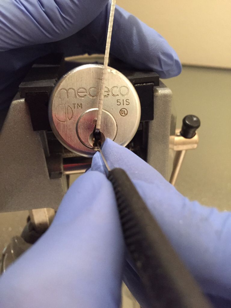

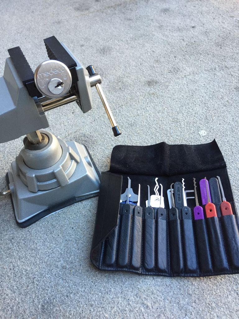

Postby Snakedoc » 5 Jan 2015 19:15
I am not sure if it's pure luck or Devine intervention (same thing) but I've had great progress since I received the new Medeco.
First thing I did was to decide on the pick, after some trial and error I found the Peterson Gem to be absolutely perfect for the job.
Pin rotation, everybody has a technique and none worked for me. I'll share with you what worked for me but honestly it comes down to hands on practice.
The idea came to me after seeing guys rake them open with Bogotas. I used a Peterson pry bar to provide CCW tension and found the binding pin with the gem. I then proceeded to pulsate the tension and wiggle the tip of the gem left and right on the pin. Play attention not to lift the pin as you wiggle. You can feel the sidebar engage with the groove on the key pins and get locked there. I do this to all the pins and then start pushing them up to shear.
I am four pins in with this method and it works great on the Biaxial.
Snakedoc

Postby nite0wl » 5 Jan 2015 19:56
Snakedoc wrote:I am not sure if it's pure luck or Devine intervention (same thing) but I've had great progress since I received the new Medeco.
An intriguing idea Snakedoc and congratulations on your progress with the BiAxial. I will have to give that a try the next time I try my Medecos, of course I still haven't mastered my Medecoder which I should practice with.

Postby ggpaintballer » 5 Jan 2015 22:32
I tried out using a diamond, regular hook, and Peterson lifter. I also wound up preferring the gem for medecos. Don't even know what I'd try with a keymark.
