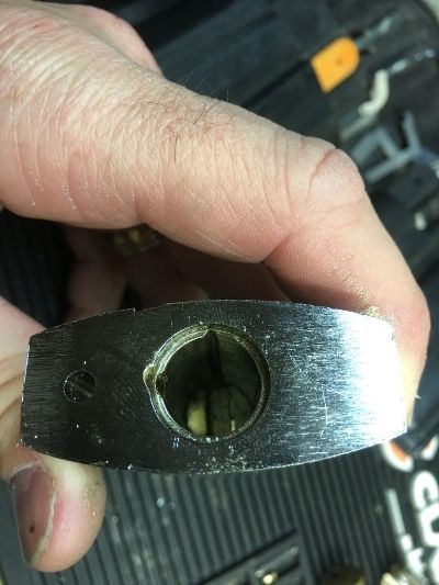

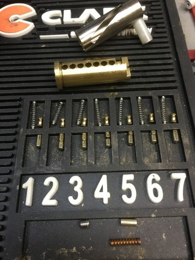

I got one of these cool Trioving locks a long time ago and after picking mine I decided to take it apart to see why it was so hard to pick.
To my surprise it has master pins in it?! Just wondering if anyone else took theirs apart at any point?
Notice the groove at the bottom from picking it so much! Also the grove to accommodate a sidebar. I guess this padlock body can be used for other higher security plugs.
One thought I had as to why it was so difficult to pick was that every time one of the master pins was picked it would cause a bunch of the others to drop down. Kind of like overlifting pins does except it would just pick it to a higher cut. Just a thought.
Also, it took some serious work to get it back together! I had to make a special wire to hold up the driver pins to slip the plug back in kind of like an Almont Rekey padlock. Except I had to have the plug spun 180 degrees so the wire holding the drivers up could get pulled out after it was in. It was an ordeal... I wish I would have made a video. :(

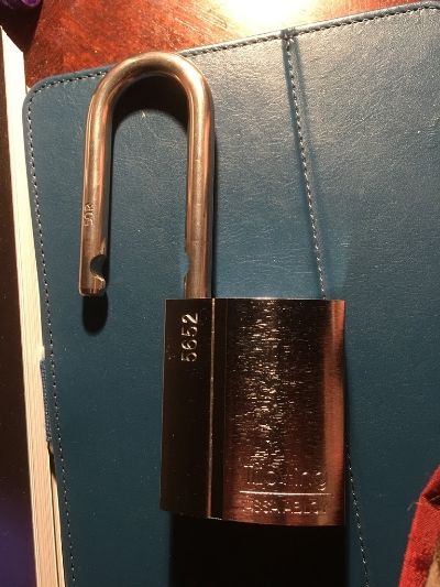

Did anyone have any joy with finding blanks for these 5652? I got it picked, but now faced with the same challenge to find some blanks. No joy in the usual profile books or Google:

Nice picking, MrA! Good seeing you back in these parts again. :D
Know you prefer real keys, but if you can't get one, that keyway does not look paracentric, so a thinner piece of flat metal could be made to work.
