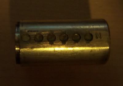

I'm pretty darn sure this is a Schlage as the keyway is SC1, the bolt was marked Schlage, and the lock mech body is held together with the usual split-pins. One thing I have noted about the shell, is that the pin-loading holes have caps in them, and are then secured with some sort of wide, blunt stamping tool, at a right-angle to the shell. Where the 7th pin-loading hole would be, a letter 'N' is stamped, or maybe it's a 'Z'. Across the bottom of the shell, it appears to have been filed length-wise, presumably to remove burrs.

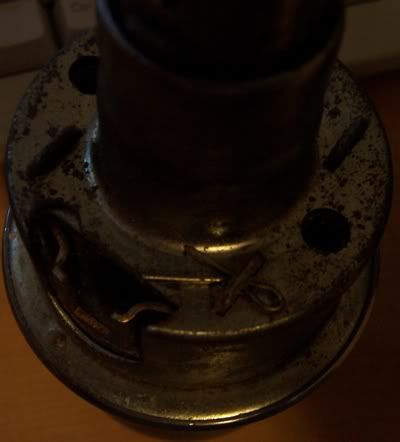

Well firstly, my apologies. :oops: Although I am still sure this lock is a Schlage, the construction is slightly different to what I posted. Here is a pic of the knob construction (which uses screws)...:
which was confused with the knob construction below (which does use split pins)...:
Here is the underside of the shell, showing the stamping marks which hold the loading plugs, and the 'N' or 'Z':

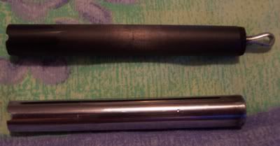

A new chrome plated, solid steel follower (made from the piston of a gas strut which holds up a tailgate) was able to push out the plug/shim...See bottom of pic below:
...much easier than trying to use the usual coiled Pepsi can follower.
Also, just completed is a carbon fibre follower (see top of pic above).
This new follower was turned on a lathe from a broken golf club shaft, which is hollow and tapered. (please don't go breaking Dad's Pings :wink: ) The outside taper is reduced to 1/2" along the length and a plastic plug is inserted & glued, to facilitate the notched "business end". The hollow centre allows storage of spare pins/springs etc. and a second removable plug is used to cap/gain access. (note split pin glued into rubber bung)

Alright Mad...as you mentioned the first lock body construction is very typical of Schlage and the newer knock-off brands using the split pin or cotter pin holding the lock casing together.
I have to admit though, I'm puzzled by the second and it's screw construction. If I were to hazard a guess, I would say that this an early Corbin or Yale product. If you feel brave enough to pull it apart, there should be some numbers stamped somewhere that denote a model of some type.
As for the Schlage plug, from the picture it looks like it's been heavily filed on (could be wear too I guess) and the "Z" or "N" also puzzles me as this seems to be the mark of someone who has worked on the lock, although I've no idea why anyone would actually bother to stamp the plug.
Perhaps they had a hundred of these on their bench and were loading plugs like crazy and decided to stamp the plug in order to keep their system organized...I have no idea...
The slots across the pin chambers look factory, and this is what leads me to believe that the particular lock or lock cylinder in question is NOT a Schlage original...I could be wrong. :? 8)

steel followers
Postby raimundo » 29 May 2005 9:09
steel followers have a lot of weight, and can pull themselves out of the lock under gravity. A piece of half inch wooden dowel won't do that and can easily be shaped to fit any special ends you might need. :)
