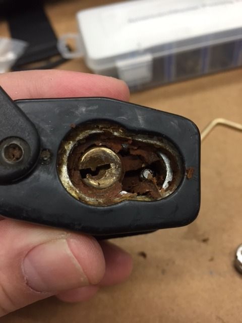

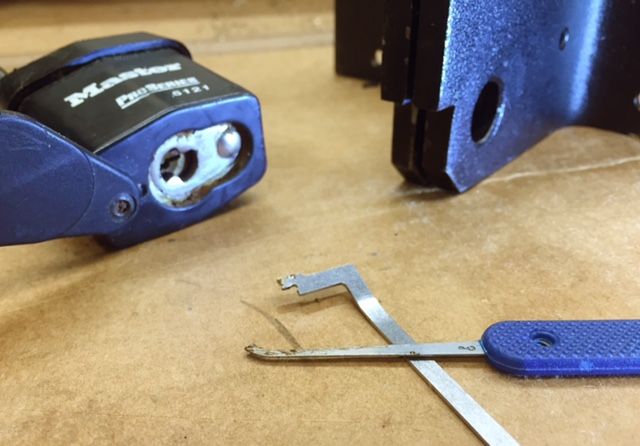

I received my NATICK hasp today and it had a little surprise along with it. Thanks Squelchtone!!!
Before I could play with my hasp I had to pass a test and get through a Master Pro 6121.
It was a bit of a challenge but I prevailed.

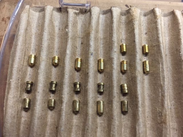

As you can see it was "a bit" dirty inside. Even the shackle hole and the bearing cutouts were packed with gunk.
Original pins on the bottom: 4 spools and a serrated, not bad for a Master lock.
I kept the 4 spools, added another stack to the 6th hole, upgraded the serrated's to the new American style, and changed all the key pins to serrated as well.
It's quite a bit more challenging now. :D

Postby 1mrchristopher » 23 Mar 2015 21:38
That looks like quite a workout to pick through! What is the purpose of the bend in your pry bar?

Postby cheerIO » 23 Mar 2015 21:47
1mrchristopher wrote:That looks like quite a workout to pick through! What is the purpose of the bend in your pry bar?
I don't really like prybars. I'm not really sure how use them well besides in a vise. The most comfortable way for me to hold a lock while picking is like this:
I bend my prybars so that I can get a little more angle on them when picking in my hands. It's not as much as the windshield wiper wrenches, but it helps.

Postby nick08037 » 23 Mar 2015 22:49
When you make your wrenches do you heat the metal or just bend them cold?

Postby cheerIO » 24 Mar 2015 0:05
Wiper blades I bend cold with two pairs of pliers. Prybars you have to heat or they may crack.

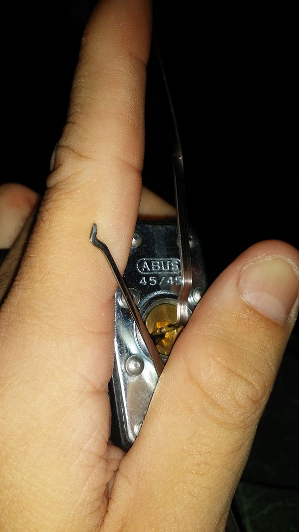

Postby Comrade627 » 25 Mar 2015 7:38
Sploosh.
SPP purist.

Postby GWiens2001 » 25 Mar 2015 9:58
Nice job with the Abus Strongboy padlock, Comrade. :)

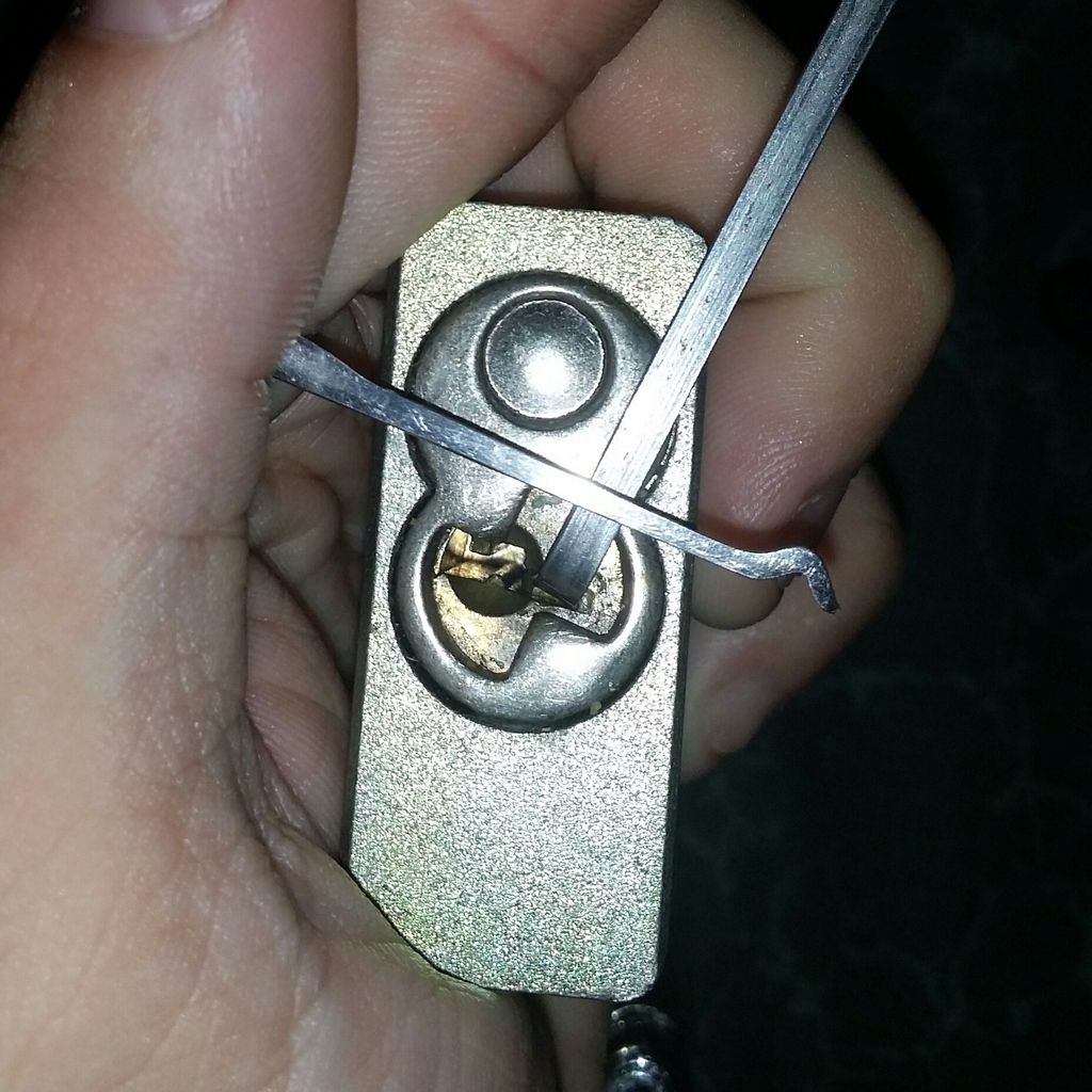

Postby Comrade627 » 26 Mar 2015 5:08
' nother 5200. This one, dated September 09, has the old keyway and pinning setup, but with the post ML body and shackle alloy. Yep, weird. I know.

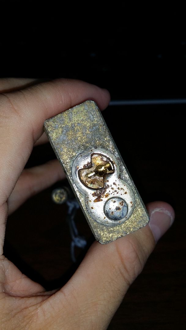

Postby Comrade627 » 26 Mar 2015 8:29
I'm not sure why, but using a homebrew single peak as an SPP works surprisingly well. Gordon, this is the 5200 with the large shackle.
That should be the 5260 series American lock. Fun pick. IIRC, it has all serrated pins. Is the bitting 27224?

Postby Comrade627 » 26 Mar 2015 8:59
Body has "series 5200" stamped, and "102" scratched into the other side. AM3 keyway, 5 pins, 4 very sharply cut spools, no serrateds.
Now I'm curious as to which you're talking about. Nice hijack btw.
Edit: Gordon thinks I have a way to check bitting.
