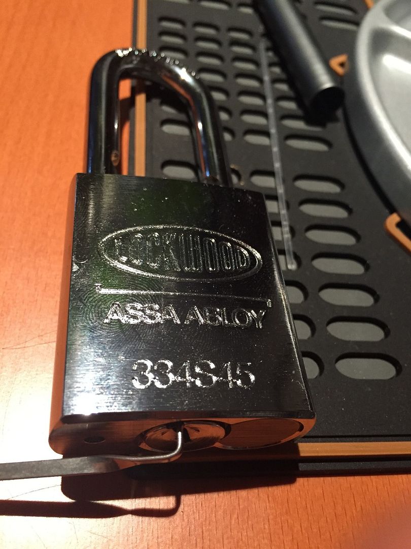

Postby Mitchell S » 31 Mar 2015 2:47
Lockwood Assa Abloy
Entertaining pick, 5 pins, all shallow spools that liked to get caught up on the sheer line.

Postby l0ckcr4ck3r » 31 Mar 2015 2:56
Nice picking Mitch!! Have they basically got the Assa pins inside them?

Postby Mitchell S » 31 Mar 2015 3:13
It didn't have any nice Christmas tree pins unfortunately, just shallow spools for all 5. They look like assa pins though.
