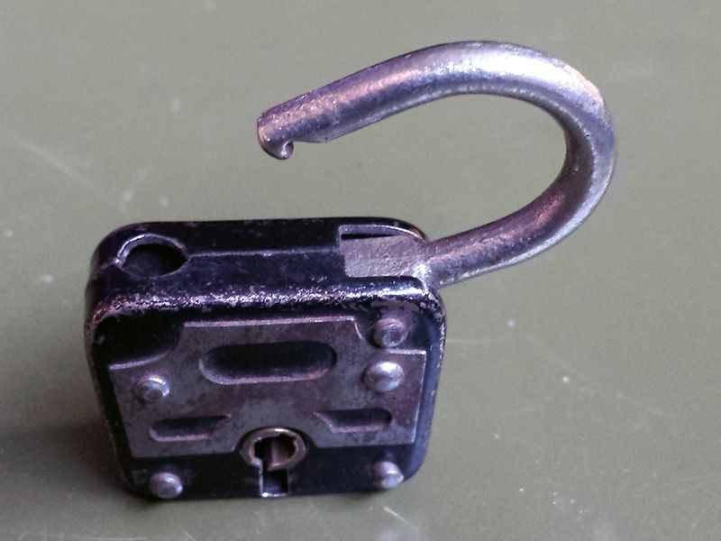

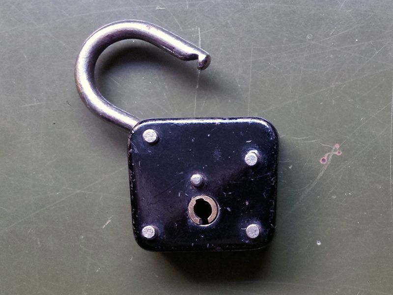

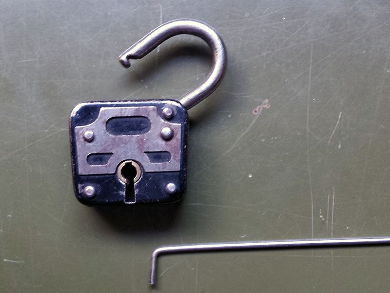

Saturday I went to a flea market and found this little cute padlock without a key. Had to buy it :mrgreen:
Once at home I probed the levers with a bent wire to see if they moved and to my surprise the shackle moved a little.
So I tried to carefully probe all the levers, one by one. There is some warding inside the keyway but every lever can be pushed up. At a certain point there's some resistance. I lifted each lever till the "resistance" point and after a few tries the shackle popped open!
I looked into the shackle hole and noticed a flat steel spring that seemed to push on top of the levers. The padlock is quite small, less than 3 cm wide (a little more than 1 inch) so it's not easy to see inside that hole.

Nice opening! without a hobbs even :D
You should make a key now! ^^

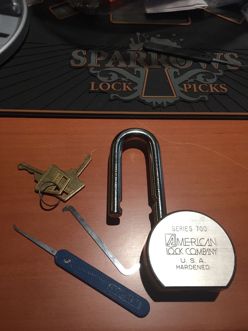

A nice 700 series American

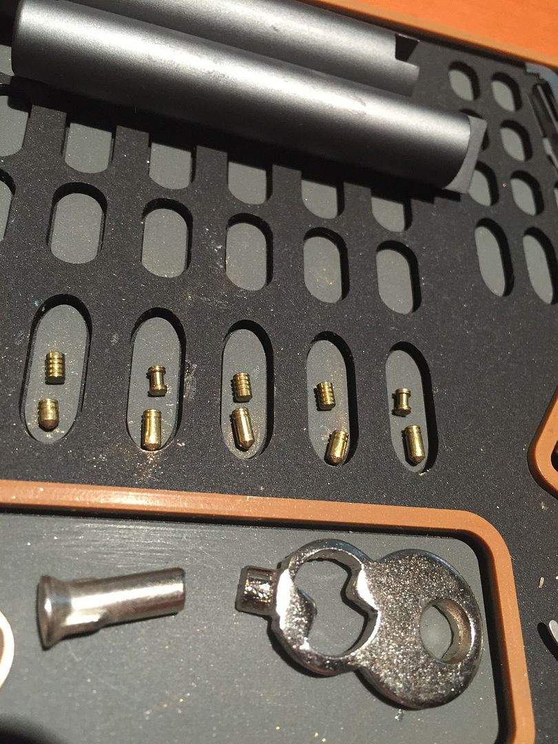

Guts

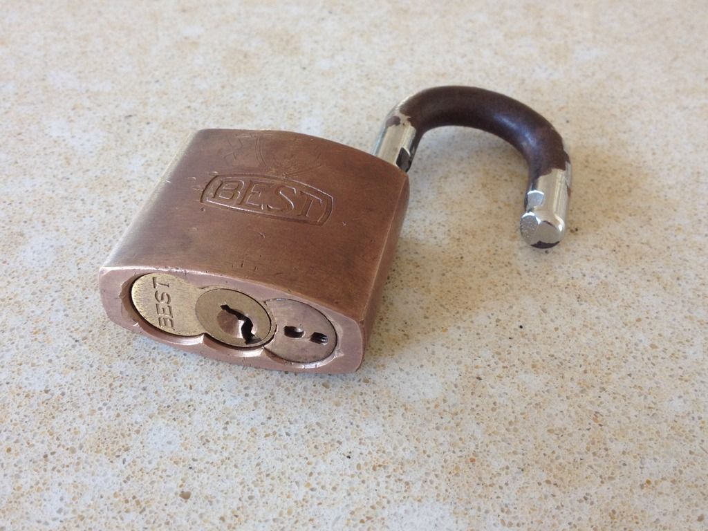

Best 6-pin padlock. This particular core was so thoroughly fouled with grease & grime when I bought it that the fifth and sixth pin stacks wouldn't even move. Simmered it in vinegar, dried, and hit it with some Tri-Flow. Finally picked it (to operating, unfortunately); took about an hour of total picking time over the course of a day.
Next up, I'll soak it with some BraKleen and attempt to finally hit control...this core's coming out one way or another. And no, I have no idea what the two drill/punch marks are on the knuckle underneath the core... :?:
