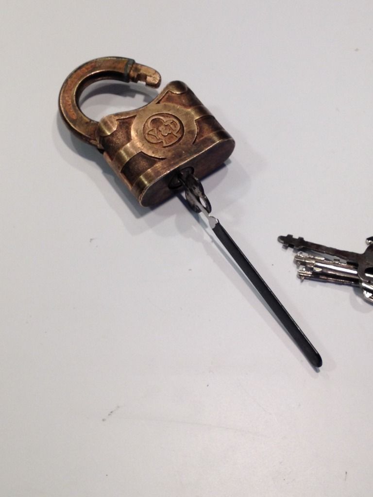

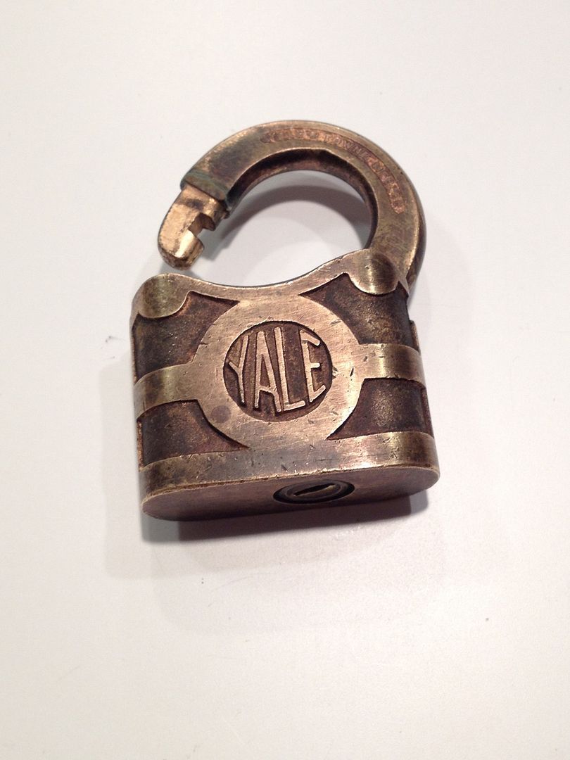

 Yale lever/warded padlock. Didn't know these were hybrid lever locks...imagine how well my impressioning attempts went. Finally realized what I was dealing with, and picked it open using a homemade warded pick to turn the actuator, with a slim medium hook slipped in around it to pick the levers.

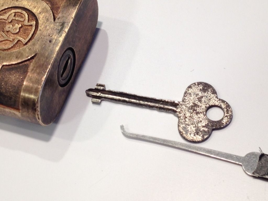

congrats for the opening robotnik. how many levers does this padlock have? I counted 4, 2 on each side. I tried picking one this morning but failed. do you have a picture of the pick you used to open it? thanks

  I counted four levers as well. With the slightly oval-shaped profile of the keyway, I was able to use a warded pick with a thinner profile than the original key, then pick around and above it with the hook in the picture.

Thanks for the pictures Robotnik. I used an L bent wire and a similar pick. I'll try again with a better shaped warded lock key and see if it opens. Dunno if the lock works because I got it without a key. The shackle pin has been driven out, probably to remove the lock from whatever it was attached to. Then it was hammered back in. It's pretty loose but it seems OK. I'll let you know how this story ends

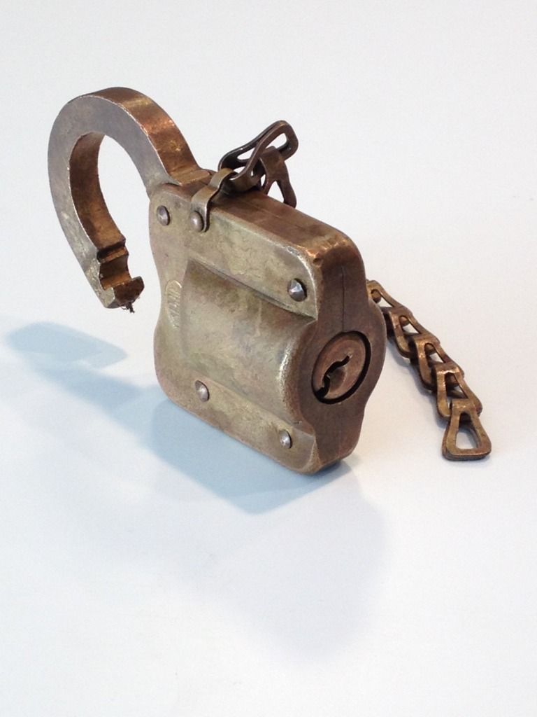

 Corbin five pin master ring padlock. Worked hard for this one; early on, it seemed like I was setting pins to both shearlines. On the five pin lock, I would set three pins, then the lock would go dead. First three pins were set, back two were springy. Finally able to break through that wall. Next hurdle was the plug turning into the deeeepest false set I've experienced with a Corbin. Had to re-set the pins and start from scratch a few times before I finally set everything and turned the plug. All told, took me a couple hours spread over a few days for this. Would love to make a set of keys, but outside of destructive disassembly, I don't really see a way to do this.

Congrats on the opening, you always pick very nice locks I'd measure the pins height with the lock in the picked position. Then close it and impression a key cut a little less than the measure I got earlier. Worked for me a couple times. You may be able to measure just the first two or three pins but this is a good start anyway. Good luck

Appreciate the kind words, and the suggestion. Feeling for approximate pin heights and impressioning from there could at least give me an operating key, so I'll give that a go. Couldn't get a master key by this method (may just need a reeeally big set of Corbin tryout keys  ), but at least I'd have a working lock. Thanks!

 Thanks for the suggestion Robotnik, I copied the blank on a piece of steel and shaved away the sides. Used it as a tensor and picked the levers. Now the padlock is open. Cheers

@Robotnik. You could try impressioning that corbin.
