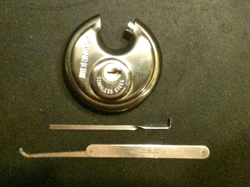

Had some time to sit down and work on a few locks I recently picked up. The first one's a Brinks Disk lock. Not much to it other than a small keyway and some security pins (serrated/spool).

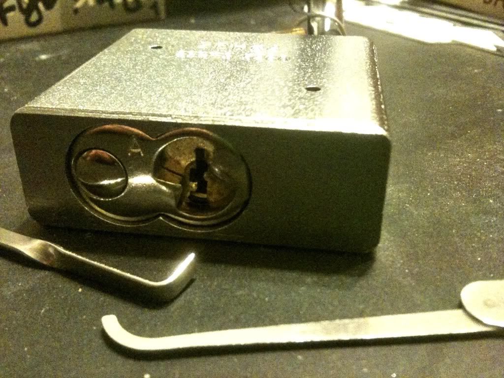

Next up was the American 5260 I have been struggling with due to it's pin stack arrangement. The last stack is a 2, with a 7 directly in front of it. After working on it for a WHILE, I finally realized that the pin stack I was trying to lift was actually the empty 6th hole, DOH!! Needless to say, after I figured that out I got it open.

Hey gilduran,
I didn't know it was possible to pick small keyways with such a huge hook! Good job.

Thanks femurat
It's a little tight to get in there, but it ends up working real well. I've tried the small hook and half diamonds, but I end up having to rotate those a funny direction to lift the stacks. Maybe if I was a lefty it would feel more natural.

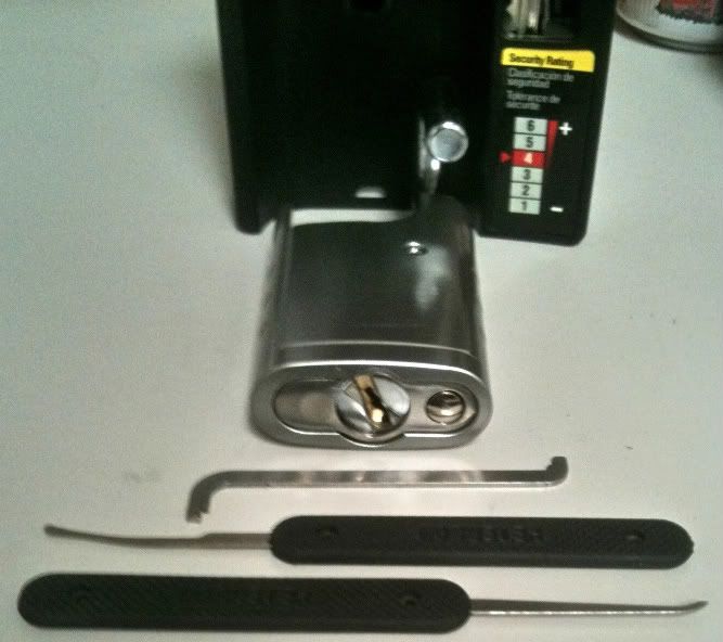

Finally opened my Stanley CD8820. I've been unable to get any of my picks down the keyway enough to lift the rear most pins, but I just received my Peterson Reach pick, and it did the trick, along with a short hook for the 6 pin. The keyways on these are (I'm not sure what the correct term is) very obstructed.
Pins 5 & 6 on this particular lock are high/low, so it was a little tricky getting past the low 5 to reach high 6 with the reach.

Since I can't edit my post, this will have to serve as my edit.
[edit]The keyways on these are very warded.[/edit]
Thanks to the Lockpicking Dictionary/Glossary/Terminology for the answer.

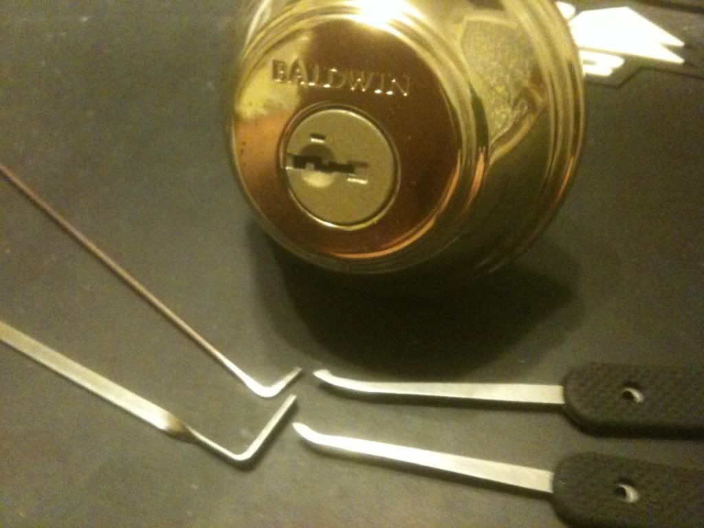

Picked (no pun intended) this Baldwin SmartKey deadbolt up a week or so ago, along with a Schlage Securekey deadbolt. Haven't managed to open the Schlage yet, but got this one open after a bit of trial and error with different wrenches. Ended up using one of my light tensioners, a piece of 1/16 welding rod I bent and filed. Only problem with this tensioner is it twists real easy, so I had to finish the lock off with a standard wrench down the keyway.

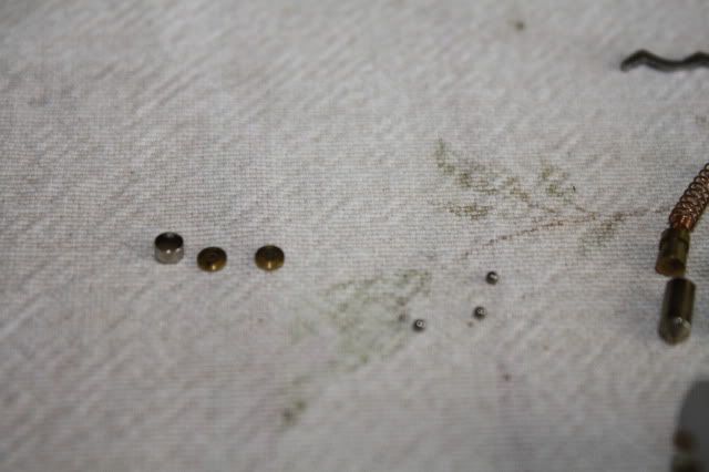

One question though, when I pulled the plug I found these.... What the heck are they?

Not sure about the ball bearings, but those other bits look like master wafers (or whatever their called) to allow for a master key.

Postby psychofish » 6 Jul 2010 18:20
Yeah I figured they were part of some kind of master key or construction key setup, Pretty strange who ever removed the lock, left them inside (as in not inside the core, but inside the housing between the two locks.
