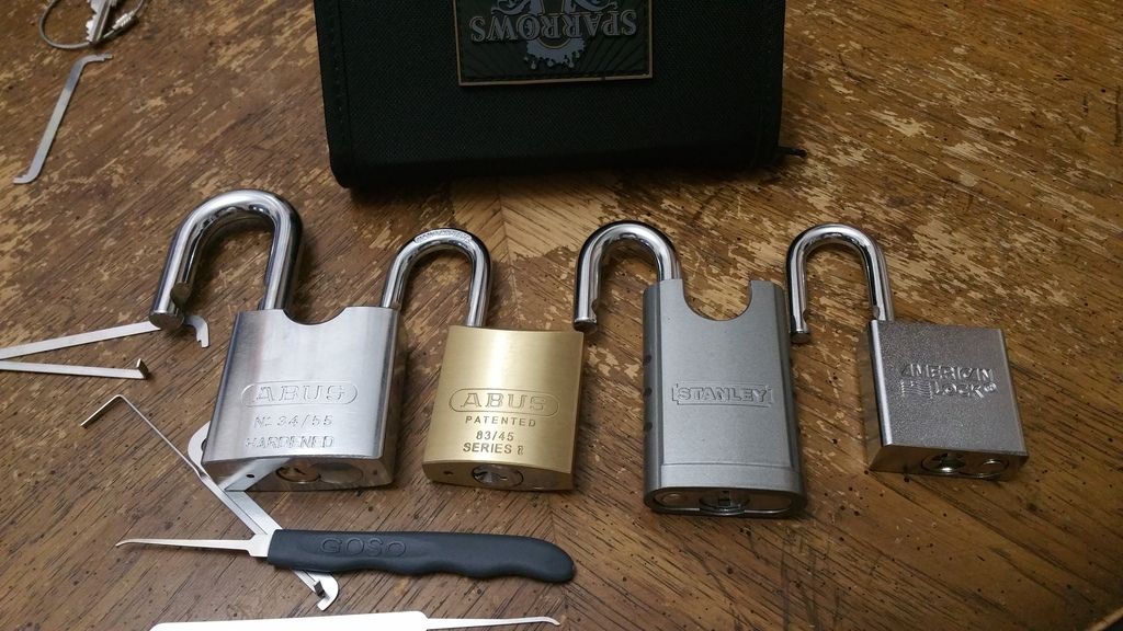

Todays picks.

Eazy123 wrote:
G-lock wrote:Image got these opened today.
That <censored> Stanley gives me the flux, lol. Constantly dropping pins, much like the Abus Titalium I'm also working on. Can't get either open yet.

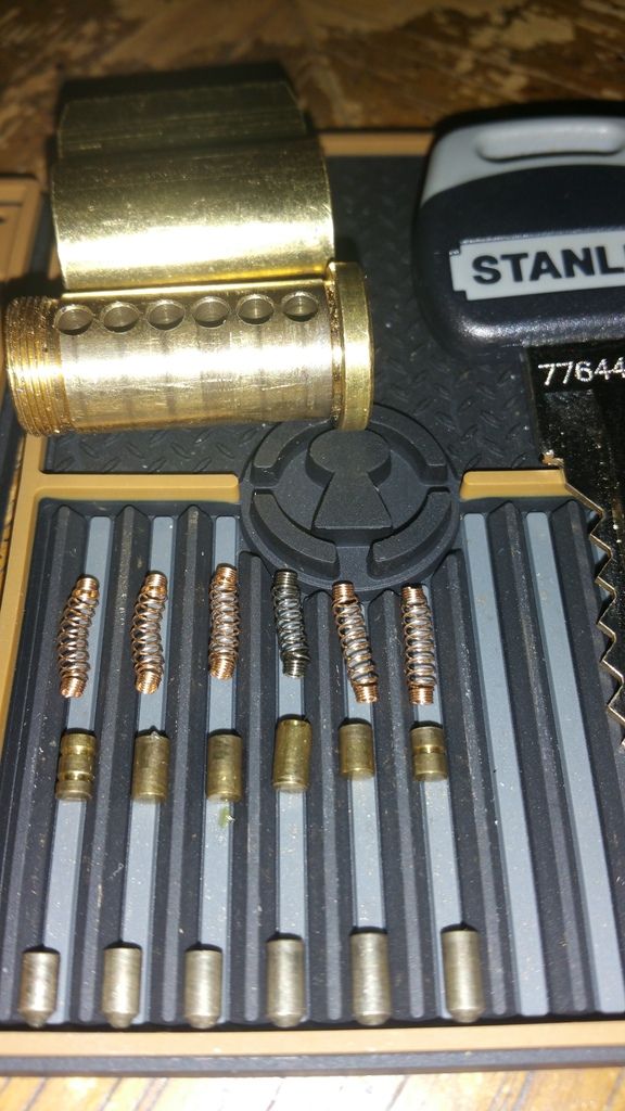

I take back what i said about the stanley being a easy pick. I picked open the other stanley that came with the set i bought this morning. although it was keyed the same & with the same security pins, it was much, much harder to pick. I would even go as far as to say its the most difficult lock ive picked. The design of the pins catch perfectly on the ledge milled into the plug and when they do it feels like i hit a wall with my hook. Then to free it up almost every set pin drops back down. Took me almost 2hours to pick this one.
