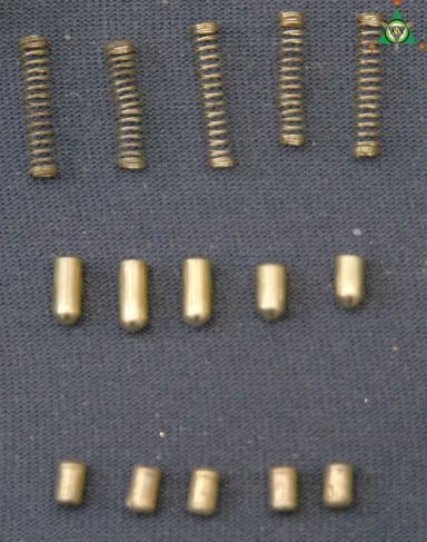

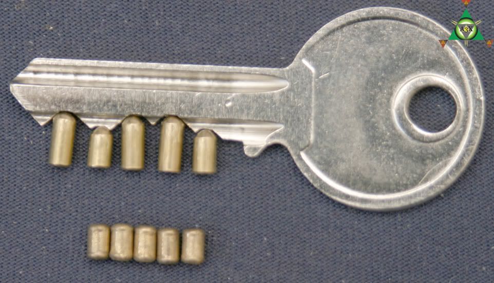

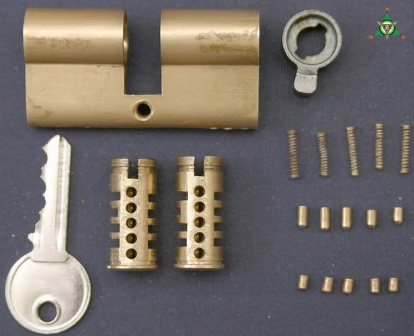

Postby atrix » 25 May 2006 10:41
hi all :D
It is very cheap lock-1.20$ with 3 keys
On it there are no inscriptions and names
I have bought it in a small household shop, the seller has told that the lock Chinese. Quality of assembly is low
This lock has interesting bottom pins, they have a rough surface because are cast from copper
Can from the rests of these cylinders Chineses cast pins :D
Thanks for such quantity of versions of an origin of these cuts
Sorry my English :oops:

Some manufacturing processes are called lightening, the holes in PSP (perforated steel plate, wwll instant runway steel matting, and the sometimes seen holes in the web of steel beams, this is done in aircraft to preserve strength but make the structure lighter.) since at least one of the locks mentioned had it and it was molded not machined, it may also be to use the least material just to make more parts from the available material, perhaps lighter means easier export shipping.
Postby Shrub » 15 Jun 2006 9:12
I wouldnt think a box of locks with that amount of material removed on the plug would make enough of a weight saving.
If the slots were for strength they would be radiused bottoms and not square.
Ive stayed out of this thread as i do not know for sure so cant comment but it perplexes me,
If the slots were for material saving why are they differant heights on some plugs.
I like the antipull idea but i dont think it would help as you would pull straight out the lack of material may make it break but you would simply reinsert the screw and pull again.
Anti drill? well its true that air spaces in material can make the drill grab and make it very hard to drill the plug out but a fast drill with a sharp bit will get through it.
Plud id at the factory? well possable as is the clamping points idea but none of the other manufactures do that and the oriental lot are far more advanced in production situations.
They are found on the cheapest locks and ones which dont have great security.
It may be that the keyway is formed cold and that a die is forced through the plug, this plug regulary moved in the clamp so fingers hold the plug and stop lateral movement,
It may be that they are cast and that the slots are where material is moved around the mould to other plugs,
It may just be a cost cutting exorcise.

If you look carfully, the drivers aren't going to fall into the cuts. the cuts are between the drivers.

They will, if you remove the plug while it's turned 90 degrees.

Okay, in that case but normally, It wouldn't
