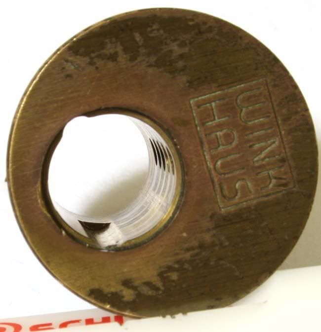

Well, for some one who has literally gb's worth of lock photos, I decided to add one here. This is the winkhaus vs5 lock. Can you figure out why the actual face of the lock is recessed? I'll elaborate later in the post 8) .

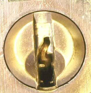

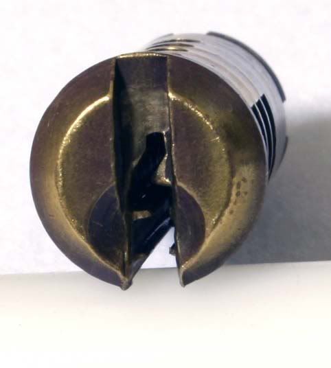

A pic of the plug face:
See how the inactive pins protrude into this area if the wrong profile key is inserted into the keyway. These passive locking pins are installed on both sides of the cylinder/plug:

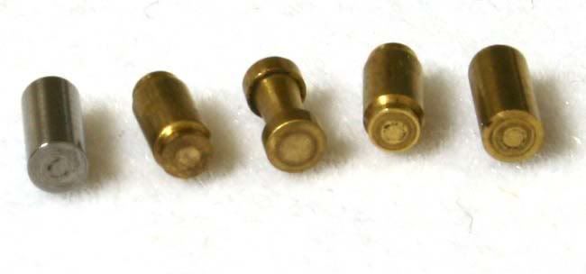

A picture of a common top pin stack. You can see 2 standard pins and 2 inverted spools with 1 normal spool pin.

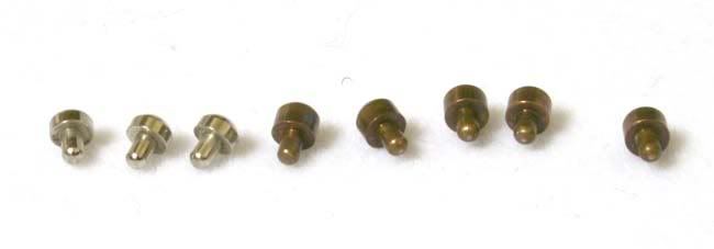

Here you can see all 8 passive profile pins in the lock sets. 4 passive pins are intalled in each side of the cylinder (Typical).

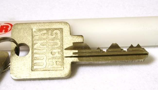

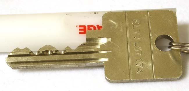

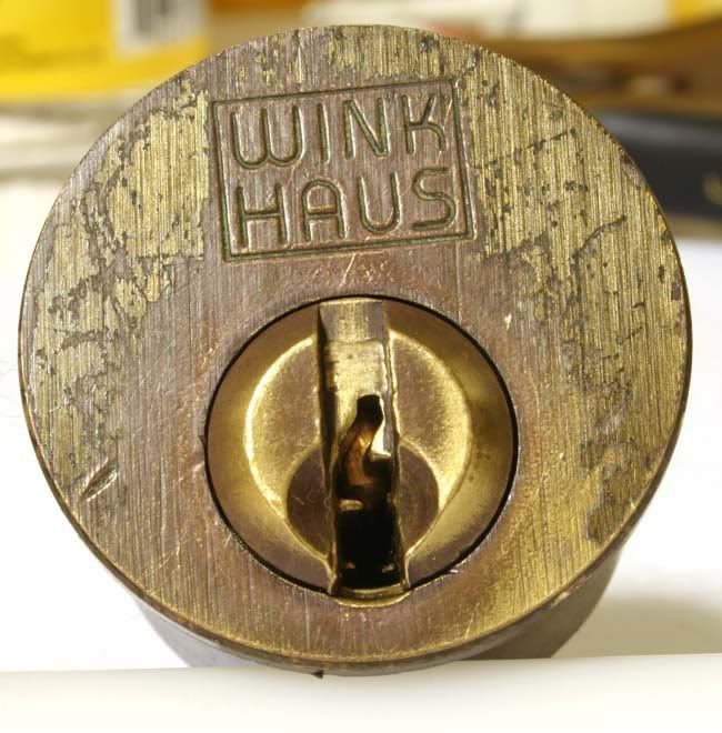

Pics of each side of the keys. Note the dimples on each side of the key blank:
Finally is a couple pics of the keyway:
Now, onto the recessed face of the lock. It is not only for asthetics, but for key strength. A very very small amount of key bending will transfer the turning force to the face of the plug and not the key blank itself. This greatly reduces the amount of broken keys you will see. A great idea on a neat lock 8) .

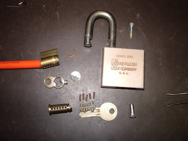

Postby poky13 » 10 Apr 2007 12:32

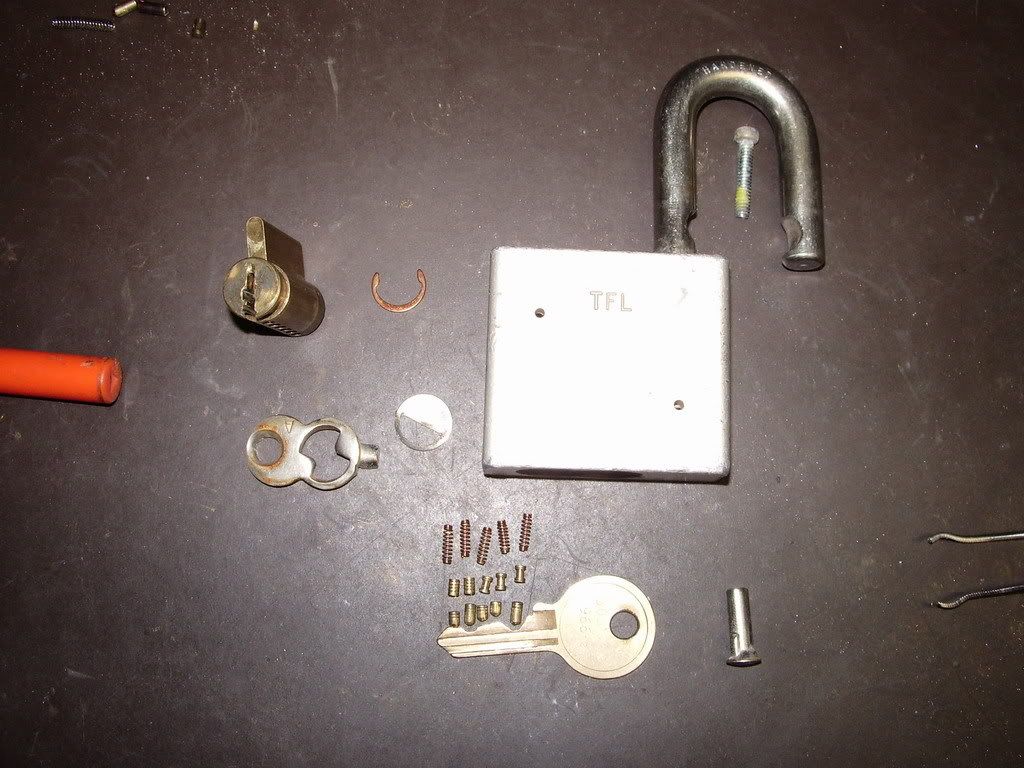

I bought these locks for my job boxes. They all are keyed the same.
I have not opened them yet only with a key, I have raked & bump keyed & and picked them. I know I'm in over my head, going back to some thing I can Pick. Here is pic of them broke down
IMG]http://i166.photobucket.com/albums/u107/ralf13/American1305001.jpg[/IMG]
[IMG]http://i166.photobucket.com/albums/u107/ralf13/American1305003.jpg
[IMG]http://i166.photobucket.com/albums/u107/ralf13/American1305002.jpg
[/IMG][/img]

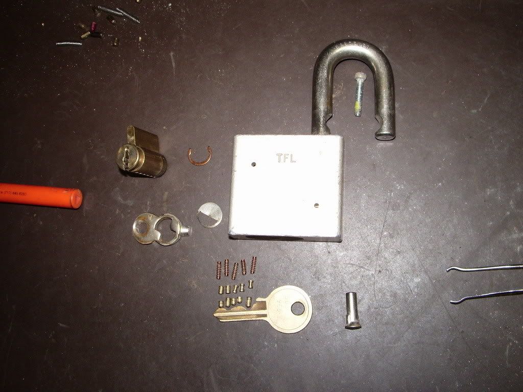

Postby poky13 » 10 Apr 2007 12:42
Here are the pic I messed up on the last post sorryImageImage

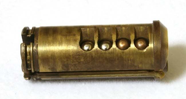

This is a very quick 40 minute job on a milling machine, shows all the working components of the lock. I'm going to write about this to my blog some day, as I have lots of more pictures of this.

Jaakko wrote:This is a very quick 40 minute job on a milling machine, shows all the working components of the lock. I'm going to write about this to my blog some day, as I have lots of more pictures of this.
I love the cut to expose the bearings! Would you mind much if I took this design on for my lock? I was originally just going to have a long slit cut in the front, but this shows lot more of what is going on.
