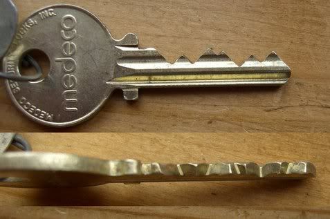

Heres my key then, it seems to have a half spaced cut in the middle of the key so does that make mine a biaxial or not?
It also has the nik out at the shoulder which i thought was a common feature of the biaxial key.
Postby zeke79 » 16 Jun 2006 9:58
Shrub,
It appears to be a standard medeco. I think it is the rotations that are giving the illusions of a biaxial spacing as you have opposing rotations next to each other in spaces 2 and 3 next to a 0 rotation in space 4. I could be wrong though. Easiest way to tell is to look for the biaxial symbol on the face of your lock which appears similar to this o0 .
Postby Shrub » 16 Jun 2006 10:00
Nope just got a UL in a circle, guess its not biaxial then.
Time to throw this wannabe piece of crap away then lol

Postby zeke79 » 16 Jun 2006 10:10
AAAACCCCCCCCKKKKKKK!!!!!!! Dont throw it away!!! They are just as hard to pick as biaxial I think!! Just less key differs.
