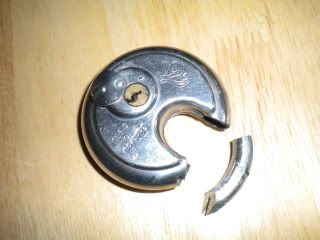

I got defeated by one of these the other day. It didn't help that it was on the sunny side of a storage unit on a 100 degree day (for a customer). It bugs though, I haven't had to cut off a working padlock in a long time.
I spent a little extra time cutting it off in such a way to not mess with the plug. Since I wanted to play with it later.

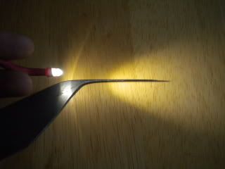

I found that it is very easy to put too much tension on the plug, which makes picking the mushroom pins incredibly difficult. When I looked in it with my light and sight tool, it was easy to spot the problem.
I could see a split in a pin that felt deep to the touch. Obviously this pin needed to be shallow. Once I knew that I was able to pick it. I just had to keep pushing the shallow pins up higher (easier said than done).

@ farmerfreak, in your picture it looks like the barrel turned counter clockwise is this so or is it just all the way around clockwise

harleythemiller wrote:@ farmerfreak, in your picture it looks like the barrel turned counter clockwise is this so or is it just all the way around clockwise
The cylinders in those locks are mounted with the pins at the bottom. It's turned 90 degrees CW in the picture.
