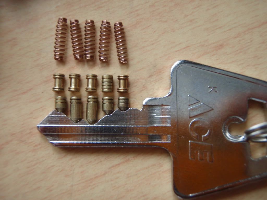

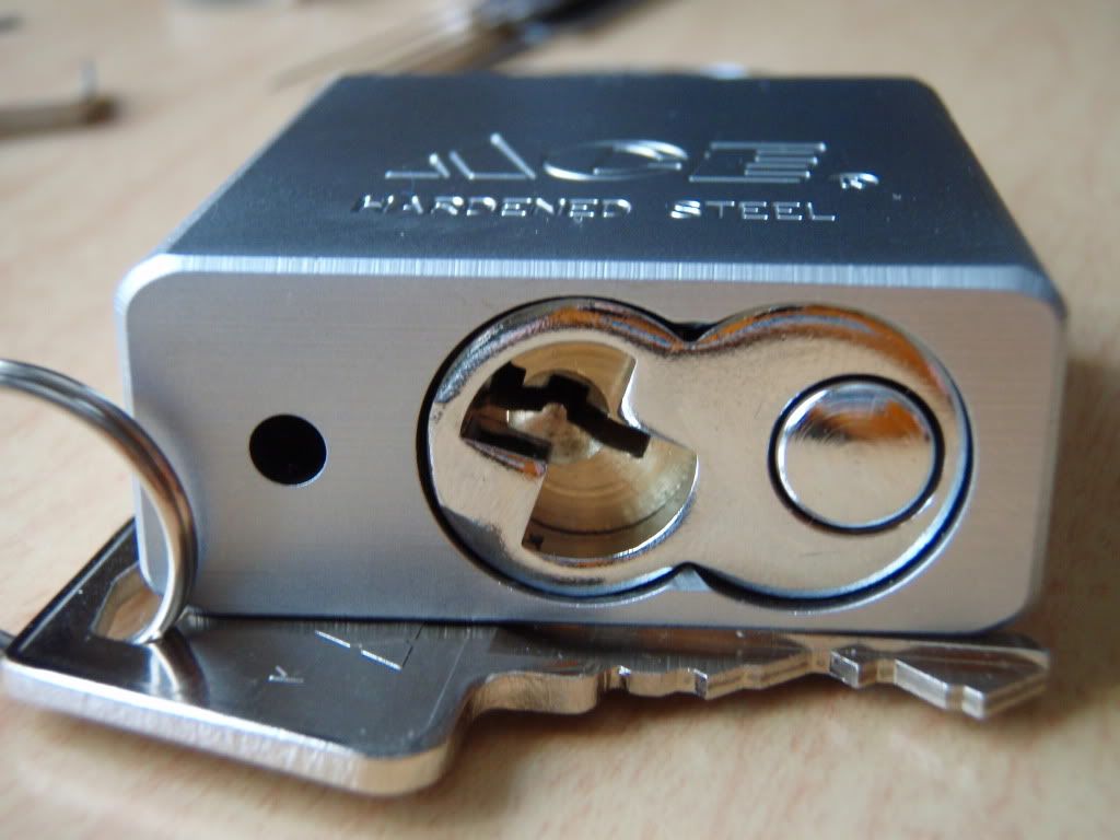

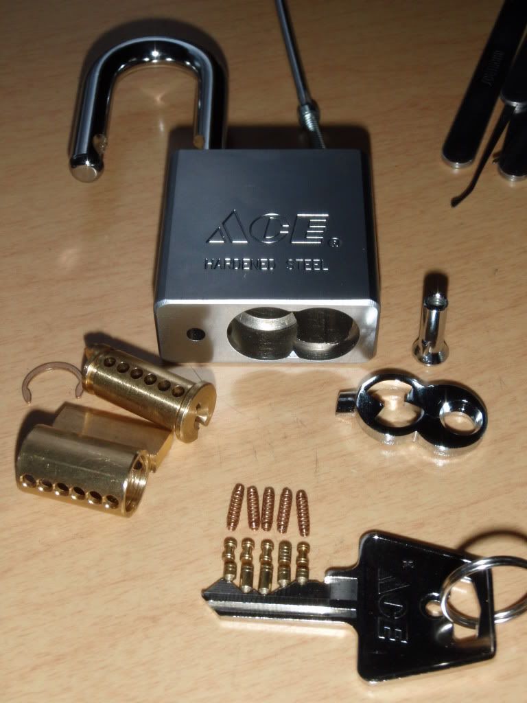

Not nearly as sexy as the other pics, but this padlock brings fond memories, for it was my first "real" challenge.
I remember taking this apart and spotting those hybrids........... like a kid on Christmas morning!
I'm assuming it's an American that "Ace Hardware" is allowed to stamp their name on. Maybe someone could explain?
lock and key http://i1121.photobucket.com/albums/l50 ... st/160.jpg
disassembled http://i1121.photobucket.com/albums/l50 ... CKS151.jpg
key and pins http://i1121.photobucket.com/albums/l50 ... CKS149.jpg
