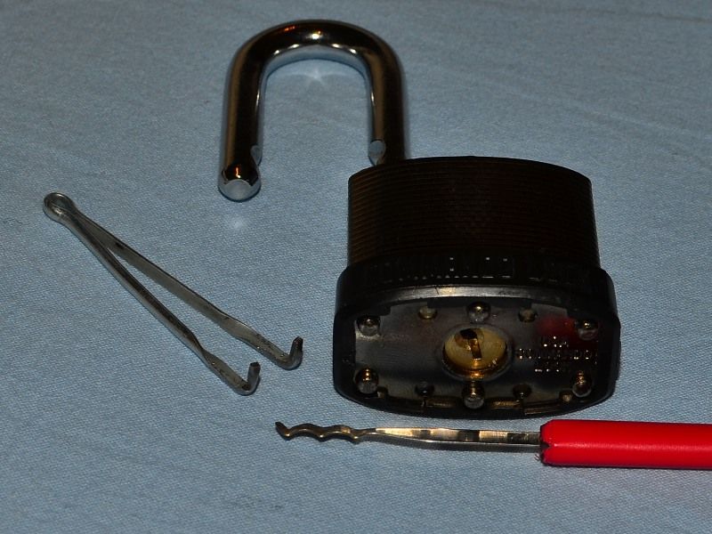

to the poster a few before me: totally possible to jack up a lock with picks, the front door of the house i moved out of didnt work too hot and it worked fine before i got into picking. heed the warnings, here there be truth.

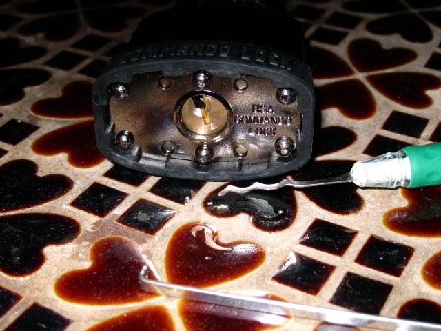

I picked my shiny new Commando lock. Only once with my bogata+TOK tension, Im glad i took a picture because i havent yet replicated this feat with a rake or by SPP. I like this lock a lot, its interesting that it has no spring that throws the shackle open (due to the interchangeability of said shackle)
well, heres the lock lurking, commando like, in my dark living room:

Postby zeepia » 20 Oct 2012 12:03
Nice job AtticRR :)
I did try to rake these earlier with no success. But your post got me trying again...
At first I got only 3-4 pins with rake and finished with hook, but finally succeeded with only bogota.
That other commando lock (government) has some Harry Potter spell on it, it doesn´t feel at all this easy.

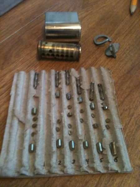

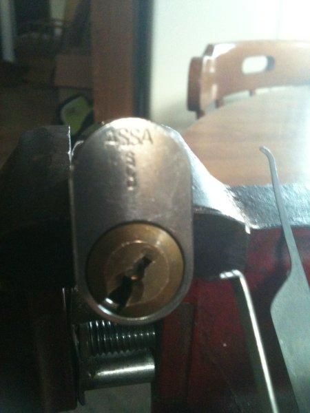

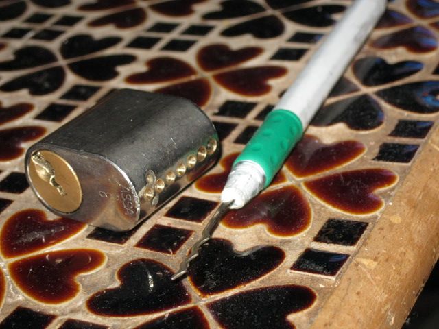

I did open the assa i traded with you though-after trying and trying I drilled out stack 6&7, worked it some more and finally raked it open. As is usual for me I lost the security pin lottery (i always do), and all mine had was std pins and masterkeying. And as you can see i lost a spring. well, i didnt lose it, im just storing it somewhere in my garage to the left of where i sit!

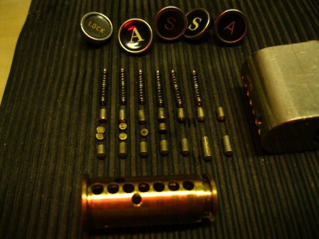

I also opened my ASSA SCD from Zeepia. Think you and I did not entirely miss the security pin lottery. It was tough to pick the lock open. Ended up doing an overlifting attack in order to make it work. 8)

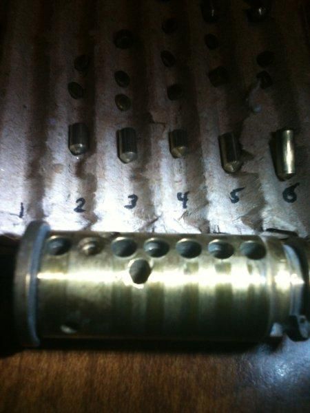

Does anything look funny to any of you in this next picture? Looks like somebody forgot the key pin, driver pin, master wafers and spring in the second hole. :?
I was wondering if my special storage area had claimed new parts, except I was on the kitchen counter. Then I saw the obvious; no wear marks from the drivers rubbing on the plug as the lock was operated. That area was almost new.
And looking at the picture again of the plug, the second hole has no wear and no dirt. Quality control was asleep that day. Also figured that there were only standard pins and master wafers. Then I look inside the plug, and saw exactly what I see in yours... countermilling. :shock: Of exactly the size to let those master wafers catch and hold! The last picture shows that both of us had our plugs countermilled in holes 1, 2, 4, and 6.
Due to the countermilling (first I had seen using master wafers to operate), I thought it was cool. This will go on my keeping list. Will practice opening this without the overlifting attack to try and improve my SPP skills.
Thanks Again, Zeepia! :mrgreen:

Postby globallockytoo » 22 Oct 2012 9:11
It was probably a maison keyed system. It was/is very common to find that in maison keying.

Postby zeepia » 22 Oct 2012 13:28

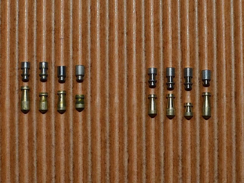

Good job in getting them open! You guys still had a bad luck. I have opened two of mine, here are some pins from them. Don´t remember what was the original pinning order.
Left lock´s plug had counter milling in 2,4,6 and right one in 1,2,4 and 6. The first hadn´t any small master wafers and the other had only a few.
Have to give that overlifting attack a try...
