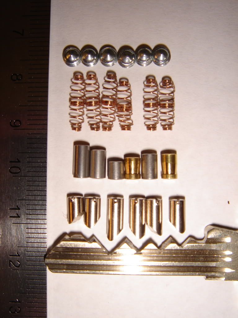

Postby FrenchKey » 24 Feb 2009 5:47
Here is a break-down of a JPM / Cisa anti-picks keyway cylinder.
6 pins, 2 dead pins on the left, 2 on the right.
(I don't know your politic about posting pictures, shall we put a link or can we put them directly on the forum ? Let me know)
No security pins in mine, but you can almost put no picks in it :D
FrenchKey
Posts: 180
Joined: 20 Feb 2009 3:37
Location: France
