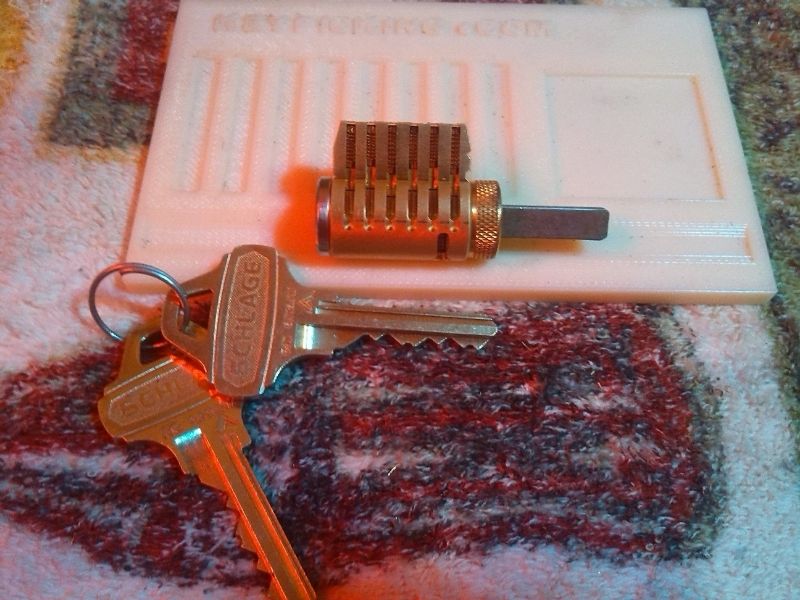

Here is what I worked on today ;)

SnowyBoy wrote:Nice SFIC - exactly how I cut mine (all three pieces together) except I don't do the square cut. I cut go straight in at 2mm.
Shame that the one I sent Gordon got nicked in the post, was lovely, as is yours.
Thanks SnowyBoy, that means a lot coming from the master craftsman! I actually machine all 3 parts of the core individually with their own fixtures and confirm tolerances and pin chamber locations for each cycle. I'm just concerned about how easy it is to chip carbide with even the slightest vibration in the part.. also i think the surface finish turns out a bit better that way.
Looking good on the 5200 Blue :)

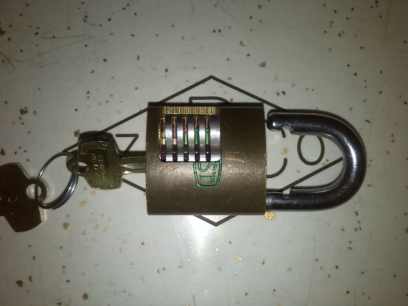

I have been busy with some other projects in the works, but here is a quick cutaway I did the other day

Nice Everest there Blue! I'm try to source some Everest Primus KIK cylinders for reasonable money but i might have to buy a bulk pack and find some helpful member to key and combinate for me.
