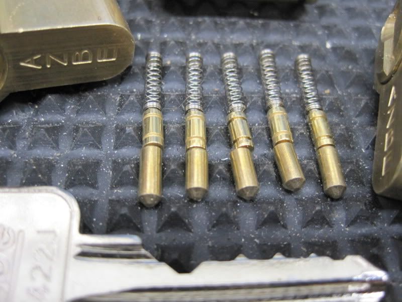

Postby Wizer » 2 May 2011 7:51
Azbe, a Spanish 5-pin euro cylinder.
I´ve had this double euro for a couple months but can´t pick it every try, so i "snapped" it expecting to see serrated pins.

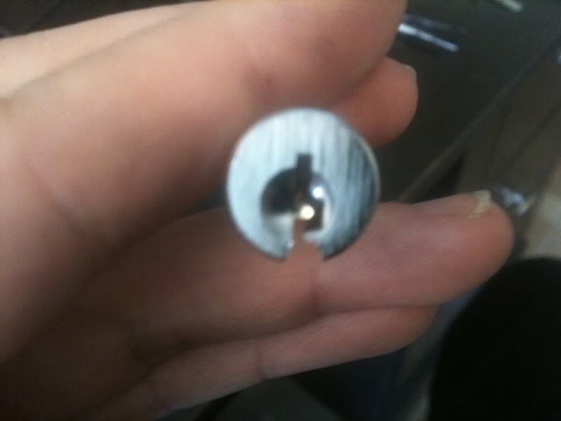

Guts from a RR Brink master ring mogul cylinder.

chriswingate wrote:Guts from a RR Brink master ring mogul cylinder.
@chriswingate:
Was that RR Brink cylinder set up for "LCK" (Limited Control Key) meaning the key at the plug can only turn one way because of a pin installed on and projecting from the back of the cylinder in the master ring, or was it standard both keys can rotate in either direction ?

Postby chriswingate » 2 May 2011 22:21
Both keys can rotate either direction.

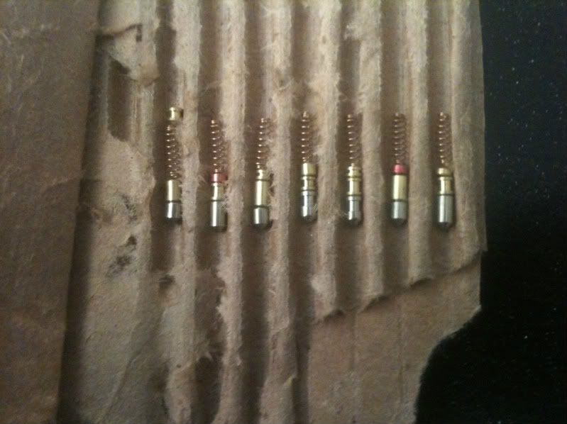

Postby Imp » 1 Nov 2011 12:21
7 Pin SFIC arrow I just picked up
I thought this lock had not been re-keyed when I bought it, but with the spool, on top of the spring, and all the security pins on a lock I thought was supposed to have none, I think someone has rekeyed it. If the mods agree, feel free to delete this post, or atleast make a note on here, seeing as I don't feel a re-keyed lock really fits in this thread. Otherwise, I just wanted to add this :D
