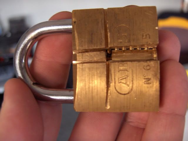

hi all,
i just finished my first cutaway of a abus 65 40 padlock. i kind of new to this cutaway stuff (actually i bought the dremel yesterday). the result is absolutely scrap!! i'm sure it's the ugliest thing you've ever seen! ok here goes the picture but i just wanted to warn you before you die of laughing.
Ok now the explanations and questions:
1st: as you see, i drilled the pins out from the top. but then i couldn't find a (good and clean) way to cap the holes again. what should i use and how to do it (because the springs always push things out)???
2nd: when i cut the holes, i cut the plug too. this is bad because when i turn the plug to unlock, pins will get stucked.
3rd: i think i did something wrong when i cut the holes... now the pins do not react the same as before. there is a friction point near the plug.. how should i cut to prevent that from happening?
Well i search the whole night for post about making cutaways. i found some pics of cutaways, the 'drilling pins out' stuff and the 'cooking padlock' trick that i will not try. wouldn' it be a nice idea to create a tutorial for this?
sorry for the nickname... if any admin wants to change it to 'jpdupere', go for it! i tried, unsuccesfully to use arabic characters...

Postby helix » 5 Nov 2005 14:24
THAT POOR ABUS, AAAAaAaaAhHHhHhHhHhh!!!!!!!
*Cries into hands*
If I were you, I'd get a little practice with your new Dremel making
a cutaway CYLINDER and make a cutaway padlock later.
* Get a cylinder and take the plug out. (yes, springs and pins out too).
* Using the plug as a guage, mark where the pin cavities are.
* Using a cutting disc, cut lines along the marks you made.
* I personally like to go a little further than the shearline.
* Make sure you clean up any edge that has been cut.
* Make sure the plug fits in and out and turns good.
* Make sure the pins drop in and out of it easy.
* Put it all together.

Postby sl_aus » 5 Nov 2005 15:33
OUCH!!
That's very similar to my first attempt on a padlock cutaway.
Below is my second attempt.
I used a hacksaw for the majority of the cuts which are visible then turned the plug so no pins were exposed.
The dremel with a cutting disc came next, that was the tedious part - very slowly taking a fraction away.
I didn't remove any pins as like you I had nothing to recap the holes with.
Not the prettiest cutaway around but it serves it purpose.

Postby DaemonLee » 5 Nov 2005 16:36
In the first picture, caught my attention was staring back at me...
Is that a fishing lure?

Postby illusion » 5 Nov 2005 16:47
What!!?!?!? :shock: :shock: :shock:
This just gets weirder... tell me - this padlock wouldn't have a tendancy to jump up and do a backflip on your table by it's own accord?
cos I sure am prepared to believe it at the moment :)
Postby DaemonLee » 5 Nov 2005 17:04
I'm going to try to do a zone blowup on it, but I'm really curious if that item came with the lock or was added in the process of the cutaway.

Postby جا&am » 6 Nov 2005 0:37
hehe thank you guys for the advice! nice picture sl... i'm going to try this way.
and no, there is no fishing bait in my padlock. it is lead and a copper wire (the only thing i had to fill the holes after the screw attempt failed). i must admit that i'm as good with the soldering iron (not sure how it's called in english) as with the dremel :wink: .
