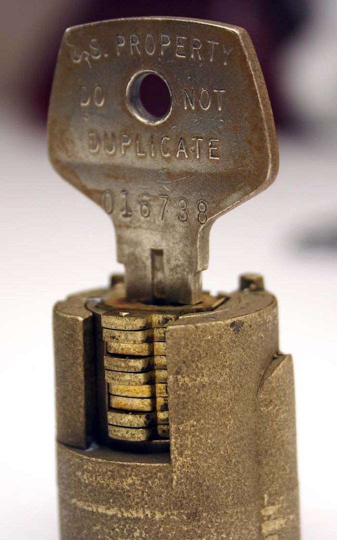

There are some high security wafer style locks out there. Here are a couple pictures of one.
Note the serrations in the sidebar gate area.

Postby zeke79 » 2 Dec 2005 13:39
The key is bitted on both sides but I dont know if I would call it a double sided wafer lock as its operation is different than standard wafers. When you insert a proper key into a normal wafer lock it is at that point decoded and ready to turn to the locked or unlocked position. This system you insert the key and it does not interface with the disks at all until you turn the key. At that point if you have inserted the right key the disks will then align similar to how a standard wafer lock would but once the key has turned enough to decode the and align the disks, the sidebar will retract into place and allow the lock to be opened.
If I have a free minute I will post a few fully assembled pictures throughout the opening process tonight.

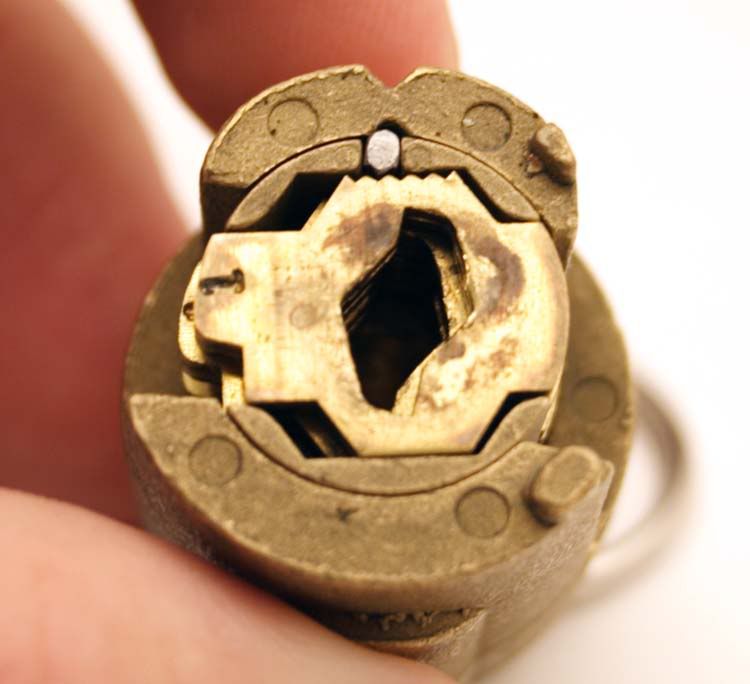

Postby zeke79 » 2 Dec 2005 20:11
Here are some operating pictures.
Postby illusion » 2 Dec 2005 20:58
hmm.. so when you begin turning the plug, the wafers catch on the side of the hull , and get pushed inwards. Since the wafers don't have springs and rely on gravity the lock must be mounted so the is key inserted horizontaly.
The sidebar isn't oval like I thought at first, but rather the right shape to nestle into one of the grooves in the serrated part of each wafer. Each wafer has those multiple serrations to confuse picking, and when the sidebar rests in the correct part of each wafer it no longer obstructs the plug,and it can turn.
I'm guessing that when the key is turned to the neutral position and taken out the wafers settle back to their neutral positions by gravity -this resets the side bar.
Thanks a lot for that Zeke - a cool wafer lock all round :)
Postby zeke79 » 2 Dec 2005 21:03
The odd shaped cuts in the disks ride on the angled bitting of the key to pull the wafers in out of the shell when the key is turned. So the key is what moves the disks. At that point the sidebar can retract and the plug can be turned. When you turn the key back it will reset the disks to the locked position.
This lock can be mounted in any direction and the disks will still "scramble" when the key is turned back and removed after unlocking.

Postby greyman » 9 Feb 2006 6:37
zeke79 wrote:The odd shaped cuts in the disks ride on the angled bitting of the key to pull the wafers in out of the shell when the key is turned. So the key is what moves the disks. At that point the sidebar can retract and the plug can be turned. When you turn the key back it will reset the disks to the locked position.
Hi Zeke
This seems to be a high security version of the Chubb AVA lock from the 1960's. The sidebar seems to have an anti-pick function, but not a usual sidebar function. I mean that the sidebar does not seem to retract into a gate in the side of the wafers, but it would tend to snare on the serrations if you are trying to pick the lock. The actual wafer principle in action here is definitely AVA.
Where are these locks used?
