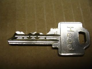

Here is a photo of a key in case anyone was wondering:

Postby pole_cat » 30 Mar 2009 23:33
Thanks for the key picture, DJHobbes

Postby Engineer » 31 Mar 2009 13:17
Yes, that is a good first post djhobbes - Thank you!
