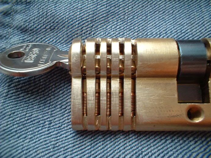

As of late I've become interested about cuttaway cylinders, so I sat down the other night and got to work making one myself. The lock is an Iseo Euro-profile, and took perhaps 1 hour to make using only a hacksaw and needle files - it looks pretty rough, and hopefuly the next one I make will be better, but it actualy works perfectly, which is more than I was expecting for a first attempt.
5 pin lock, 3 spools... it is actualy the exact same lock I posted videos of bumping upon.
Photos:
Pins set as neutral:
(you'll no-doubt notice I cut too far on the first pin... oh well lol)
Key inside:
Key turned:
(you can see the somewhat shoddy cutting of the plug)
The plug pulled out slightly to show the cuts:
Please tell me what you think, and if can give any advice for future cut-away locks it would be greatly appreciated.
Thanks all :D
B.

Thanks for sharing. I'm tempted to try on my Abus euro. It may give me some picking pointers. Do you find that filing away part of the pin hole changes the feel when picking, it's always been my concern? There could be new edges to catch on.

Postby illusion » 5 Feb 2006 10:41
hmm... well it functions fine, but obviously you're aware you need to file the edges of the holes properly so they are smooth. I haven't really noticed any difference since I made it in terms of picking.

I like this style of cut-away. Very nice.
I'm only curious why you feel you cut too far on pin 1. What if you were to cut the whole way around the cylinder, and down one side of the pin shafts and one side of the plug? This way you can watch the plug turn in either direction, and also allows more light in to see better.

I'm only curious why you feel you cut too far on pin 1. What if you were to cut the whole way around the cylinder, and down one side of the pin shafts and one side of the plug? This way you can watch the plug turn in either direction.
Cutting any further doesn't serve much of a purpose... it was the movememnet of the pins which I was most intersted in, but I guess It wouldn't hurt to simply cut the other side so you are able to see the plug turn fully... worth baring in mind, thanks :)
The style was 'borrowed' from the one on theMultipick website, but it didn't have the plug cut so it's not a full spin-off :wink:
If you become really good at these, would you be willing to sell them? :)
When I am able to make them without the small errors people would object to, which are present in the one I just made, I'll perhaps sell a few on Ebay... Thanks for your response :D
