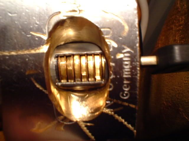

Essentialy a safe combination lock operated by a key - the key turns each disc the correct amount, so the sidebar can fall into each gate. The false cuts make it harder since it's difficult to tell if you have the gate aligned or not.
The insides look something like this:
I need to finish the cut-away soon, it needs some cleaning up - unsteady hand with a Dremel to blame. :oops:

Nice cutaway illusion.

Postby illusion » 3 Apr 2006 20:27
Thanks, but I need to clean it up and get the shape a bit better - as it stands it is fully functonal, , but I'd like it to look good.
A smooth file to remove the marks, and some wet&dry paper should haelp matters. :)
Postby mh » 4 Apr 2006 16:41
But will also remove the chrome plating, right?

Postby illusion » 4 Apr 2006 17:30
mh wrote:But will also remove the chrome plating, right?
Anyway, are you going to sell it?
Yeah, that's unfortunate really - the lock will end up being brass on one side.

Postby n2oah » 4 Apr 2006 18:32
illusion wrote:I need to finish the cut-away soon, it needs some cleaning up - unsteady hand with a Dremel to blame. :oops:
Don't worry, your dremel hand will steady up with enough use. Now I can barely feel the nicks and cuts my dremel gives me! :lol:

Postby skold » 6 Apr 2006 6:19
For the type of lock it is i would use a drill press and a larger drill bit, as it would look alot cleaner and prettier.

Postby quickpicks » 7 Apr 2006 20:34
:shock: How can you afford to do that to a Abloy? I payed 90$ for one lock. Nice tho.

Postby ThE_MasteR » 8 Apr 2006 9:30
Nice cutaway, dosen't even look functional so much it's nice.. :wink:
