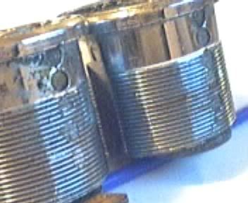

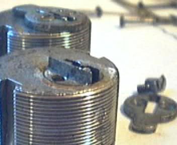

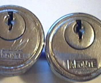

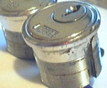

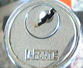

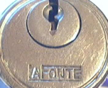

I got this lock into possession, it´s my neighbors, he asked me to repair it(make a key), no stress, anyway to make a short story long,
I can´t pick it, could it be that I have bumped into a quality product here? Cuz it looks like a Medeco(the one Zeke is picking). Or is it my skills, hehe could be, I have only been pick´n since 12. Sep 2005
What is wrong with this lock man :x
I need help
It has five pins and it needs hard tension, the slightest let go and the pins fall!

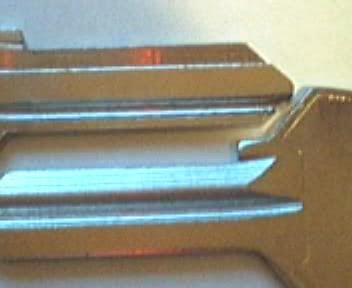

I almost forgot to post a picture of the key, but here it is!

Postby Shrub » 14 Jun 2006 20:50
Its not actually anything like a Medeco ive seen the keyway is a pretty standard one and easy to get picks into,
The lock could be better quality than your used to but to be honest i dont expect any decent security there against picking,
You may find a spool pin in chambers 2 and 4,
If it needs heavy tension then so be it some locks do,
I think the simularity is in that its a screw in mortice cylinder but thats common im afraid,
The Medeco keyway is shorter and wider than that one and the keys are a lot thicker on the cut part.
You should try shimming it open and rekeying it that way, if you keep picking it to no avail you may make the lock un-useable for its owner, do the job at hand and then go and source one to buy if you want.

Is it just me or does that key look like a blank?

Postby digital_blue » 15 Jun 2006 3:02
Jason13 wrote:Is it just me or does that key look like a blank?
Nope. It's just you. Looks like the key is cut to 64534 to me.

Postby Jason13 » 15 Jun 2006 3:33
Image i can only see a flat platform :?

Jason, see the smiley db put on his post? now read the OP, youll note there are no keys and he has to make some, they are blanks.

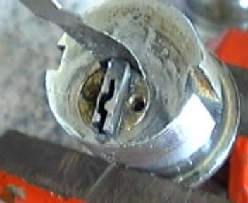

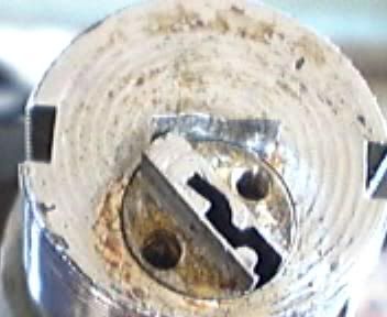

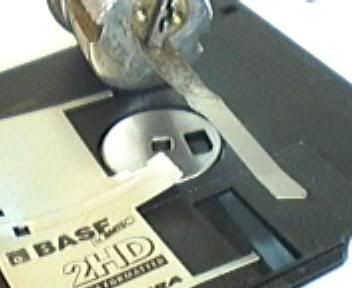

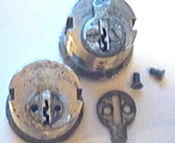

Postby Wrenchman » 15 Jun 2006 10:43
Image Image Image Image
Ok, so here´s (I)what happend:
I (don´t)made a shim out of a floppy disk, I had flatten it even (read)more than it was.
But the shim went (stickies)only in until pin 4, so I picked the last 3 pins.
And the plug turns :P
But the shim is stock and (enough)broken :(
Now what :?:
:D

Postby UWSDWF » 15 Jun 2006 11:05
Postby illusion » 15 Jun 2006 11:06
Push the plug out from the back... the shim is a bit thick so you may find you have to push quite hard.
IMHO you should have used a thinner shim made from a security tags on DVD boxes... but there you go.
