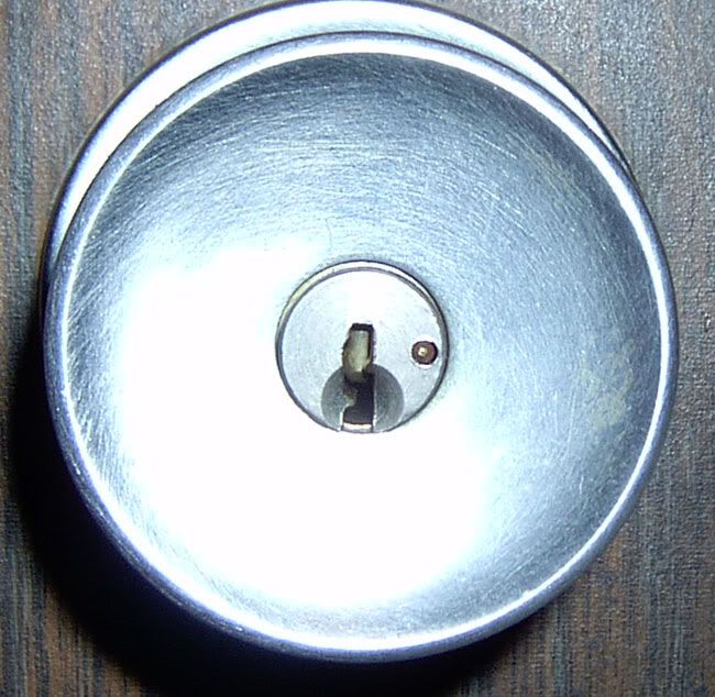

Postby n2oah » 16 Jul 2006 23:16
While doing some urban exploration in an abandoned hotel, I saw these locks on all of the hotel rooms doors. I am wondering what the pin to the right of the keyway is for. The pin appears to be spring-loaded. The locks ia a sargent.

Postby Squelchtone » 16 Jul 2006 23:33
Just a guess here, but I'm going to say that if you put in a master or control key, and press the pin you can pull the core and take it down to the hotel's keyshop and have the lock rekeyed if a change key was lost by the person staying in the room.

corbin ring cylinder
Postby raimundo » 17 Jul 2006 8:53
because the lock face is large and the plug is in the center, I am betting that it may be a variation on the corbin ring cylinder (hope i named that right) which is a system that has a master key setup that cannot be "rights amplified" in the way described by matt blaze. There is a second cylinder between the plug and the lockcylinder, and the master key unlocks this one. as for the little pin, that most likely is the lockout to keep the maid from walking in on the guest, its a common old type of hotel lock, and this function can be operated from the inside of the door, but a managers masterkey likely could open it. If you get a copy of one of these locks and dissasemble it, let us know what you find.

Postby raimundo » 17 Jul 2006 8:58
A second look at the picture tells me that its just a kik with the privacy lock and not the variation on a corbin ring cylinder, I saw that tulip knob as a cylinder rather than a knob and thats how I made the mistake. This is a common hotel lock, of maybe the 1980z. when the privacy function is applied, the little pin comes out and indicates to the maid that its locked from the inside, it also disengages the ability of the maids key to function, but as I said, the manager has a key that will open it. you can just press some button on the inside and see the pin pop out. I would assume that the system is mentioned in Lss
Postby Varjeal » 17 Jul 2006 10:31
raimundo is correct, the pin location indicates whether someone is actually in the room or not. On the inside knob the center button is used to push that little pin out. This causes normally cut keys to be unable to operate. Generally the masterkey has an undercut near the tip which can bypass this function to allow entrance.

Postby n2oah » 17 Jul 2006 14:40
Varjeal wrote:raimundo is correct, the pin location indicates whether someone is actually in the room or not. On the inside knob the center button is used to push that little pin out. This causes normally cut keys to be unable to operate. Generally the masterkey has an undercut near the tip which can bypass this function to allow entrance.
Thanks. There is a little sign above the lockset (in the room) that says something like: "Do not push in center while leaving room, only push while in room for complete privacy".
