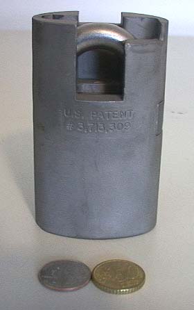

So anyway the story is that my father has been through a high number of burglaries over the past several years at his rural country home. He recently lost a brand new riding lawn mower and was asking me for some advice on good locks for his shed so I started hunting around. While resistance to manipulation was a high priority, protection from brute-force was my primary concern. Eventually I found a surplus dealer on Ebay selling the retired Sargent&Greenleaf 831B padlocks. After further research I decided this was about the best that my money could buy. So anyway, he was rather pleased to receive this for his birthday. It turned out to be a near-mint lock that appears to have never been used (Evident by the inspection sticker still on the bottom). I took the opportunity to disassemble it and take some photo’s before I presented it to him.
I didn’t take a precise measurement but I am guessing it weighs about 4-5lbs. The body is cast steel and there are only 5 parts not counting sub-assemblies, I didn’t see much that could go wrong. It’s obviously resistant to shims and the 6-pin Medeco core is “good enough” for me. Coins are US quarter and Euro 50 cent.
Front View
(Well, ok it's actually the back of the lock but you can't see the shackle from the front)

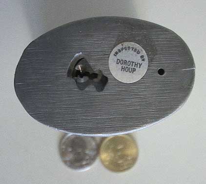

Notice the hole in the right side of the body
Bottom
The strange shaped of the key hole is used to prevent a normal key from turning backwards for disassembly. Also I believe this is (or was) a restricted keyway only availble to the Fed, someone else might be able to provide more info.

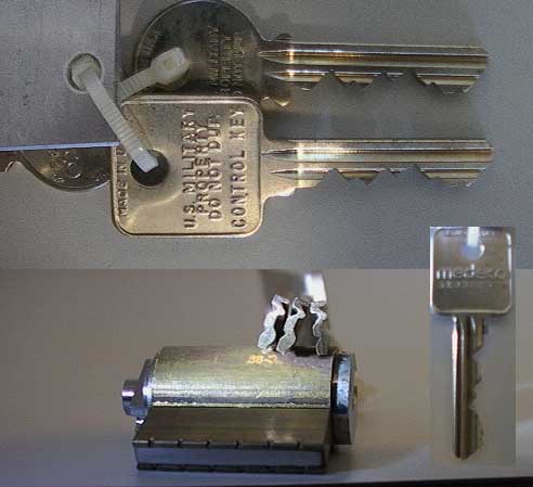

The Medeco core and a shot of the keys. The normal key is on top, the control key is bottom.
The only different between the control key and the regular key is the shoulder. The odd looking key hole interacts with the shoulder to prevent a normal key from turning backwards for disassembly and maintenance. I have more photo's also, at some point I plan to put a site up with pictures from my meager but growing collection.

I would be happy to explain. The control key turns backwards from a normal key and pops the square piece out of the side. In fact, if you hold it so that your hand doesn't cover the square cutout on the side and quickly turn the control key it will usually pop out a little on it's own. Sometimes it takes some jiggling though.
After that slides out it exposes the inside of the lock and the "shackle restrictor" can then be dropped out of the top along with the core. I always enjoy seeing designs so simple work so effectively, this lock only has 5 pieces.
