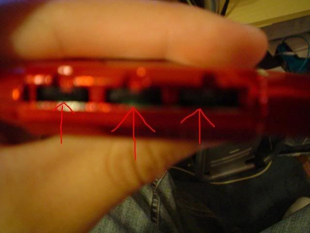

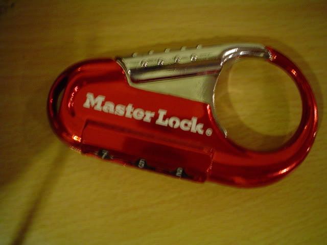

Ok, ok-- this is nowhere near the level of a Tobias discovery, but I'm pretty proud of my observation. :D So my girlfriend got me a Master Lock combination lock for my back pack along with other gifts for my birthday (she knows I like to locking everything up). I told her I would find a bypass soon.
The next day I was applying tension while turning the dials seeing if it would stick on a certain number (a common security flaw in many combo locks with dials). This wasn't working so well. Luckily, I observed that under the dials were some green rotor things with bumps on the edges (pictured below). At the correct numbers there are two bumps with a bigger separation than the rest. So I changed the combination, and wa-lah, the same thing. I wowed her later when I told her to change the combo, mix it up and give it back to me. :D
So the key is to get all three rotors so that the bumps with the biggest space between them is visible to you. Sorry for the blurry pictures, my camera is kind of sorry for up close pictures.

Postby Schuyler » 13 Sep 2006 9:32
Very cool!
Any discovery is a good discovery :D Nice work.

Postby Schuyler » 13 Sep 2006 22:26
So!
I went out and bought this lock. :) Awesome.
There is a bit of a flaw in this method, however, as mine wasn't lined up exactly the same as yours, however, the wheels DO all have to be turned in the same direction, which reduces the possible combinations of this lock to
(drumroll)
10!
hahahaha
Anyhow, hi-five on this one, man. Hopefully someone will actually publish this finding...or maybe you should?
Anyway, these locks shouldn't exist, not with such an obvious, easily exploited flaw.
10 combinations!
Postby lockedin » 14 Sep 2006 1:37
Schuyler wrote:So!
(drumroll)
10!
Really?! Hmm.. yeah maybe it was the way mine was constructed. That sucks-- it worked so perfect. Well, I guess narrowing it down to ten isn't bad. :D Thanks for double-checking Schuyler.

Postby Schuyler » 14 Sep 2006 12:33
Wait!
Update.
There are, in fact, 2 ways to decode this lock, depending on the light offered by your environment.
Your way does work perfectly! I was only able to clearly see the bottom of the green discs, which have a large gap at one point, which all must be lined up alike (facing to the right) in order to open.
On top of the green discs are the notches/ridges you mentioned, I had not seen them before because the angle I had mine at didn't immediately reveal them.
My ridges lined up exactly the same as yours did.
So, 2 methods of decoding this lock, so far both exactly the same (check the bottom of your green discs so we can verify, if you have it laying around)
woot!
I'll try to borrow the girlfriend's camera to take some clear macro shots tonight.
Postby lockedin » 15 Sep 2006 2:28
So my trick does work. Good. :D It would be really cool if you could get those macro shots up.
