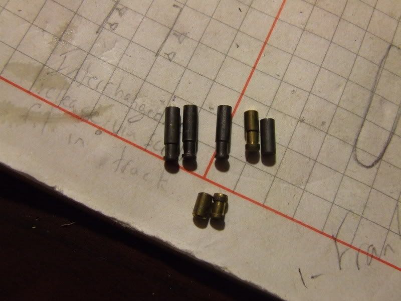

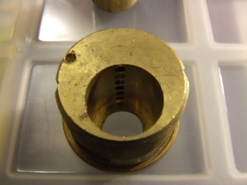

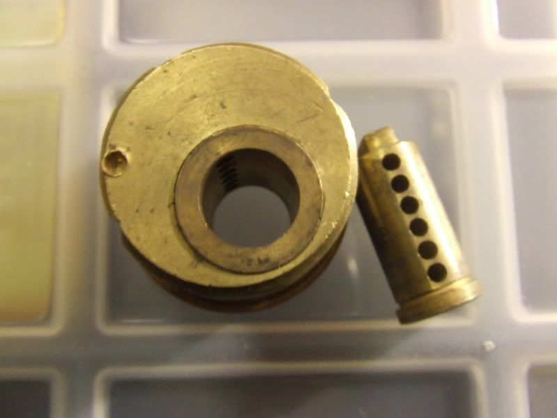

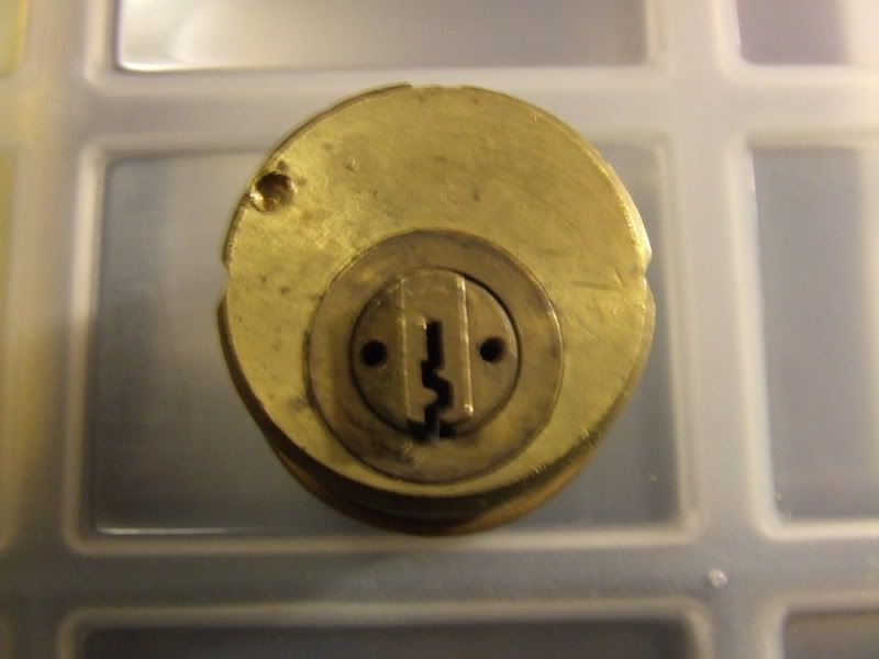

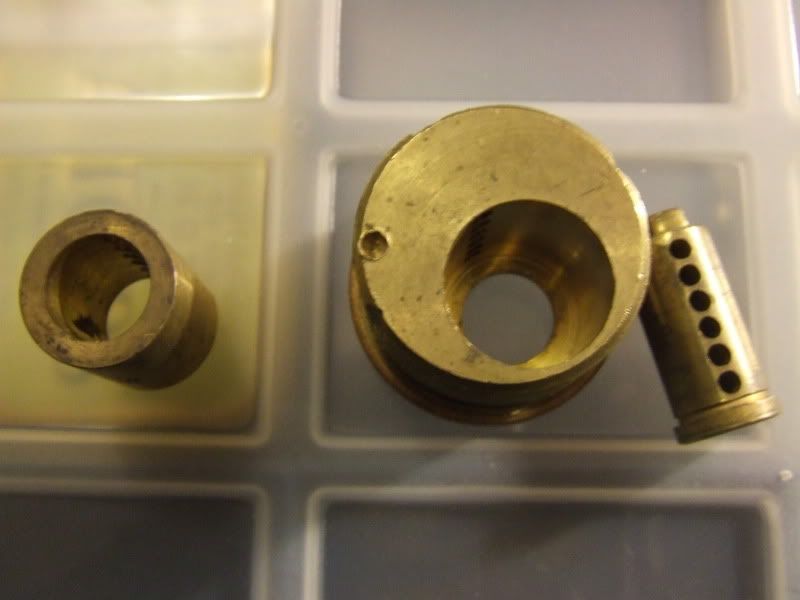

Postby unbreakable » 6 Oct 2006 23:23
Here's an interesting lock.
NOw here's where it gets screwy... :twisted: :twisted:
Oversized Corbin pins on top, two regular pins on the bottom.
Can anyone tell me the point of these two plugs(?) :?:
Its a real stumper......

Wouldn't it allow an additional layer of master keying? So that you could have multiple master keys that would work on the lock? It would be interesting to see how it feels while picking.

dosman had it right, this core has what's known as a master keying ring. These operate very similarly to SFIC's, however both sheer lines simply operate the lock. Judging by the long driver pins, it looks like the master ring was not utilized in this particular lock, so it will operate and pick like any normal lock. I've seen master ring type locks pinned like this with long driver pins when the master ring is not used.
Picking these is very similar to picking SFIC's (when the master ring is utilized); they can be fairly easy, or nearly impossible to pick, just depending on the particular lock. Unlike SFIC's, a finch type torque tool doesn't exist, as there are no holes or other features on the bottom of the master ring (the finch tool torques the control sleeve of SFIC's using the holes on the bottom of the sleeve that are there for ejecting pin chambers). There is no real trick for picking these to one sheer line, other than a bit of luck.

I knew what it was when I saw it, but had to look it up to refresh my memory as to what it's purpose was. Essentially, it allows masterkeying to be done without decreasing pick-resistance and also reducing the possibility of cross-keying.

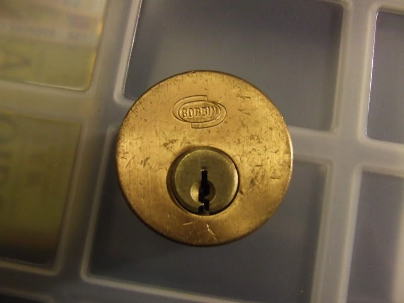

That's very interesting! Thanks for the pictures Unbreakable.
Now, does that look like it says "Borbin" to anyone else?
Postby What » 7 Oct 2006 13:46
prolly a Corbin knockoff.

Postby UWSDWF » 7 Oct 2006 13:48
nah.. its the curly's on the C

these old corbin ring cylinders are often salvaged when an old hotel goes down, early twentieth century, to mid century I think, allow for security with master keying, often used when there are floor masters, managers masterkey, and other levels of access programed by the cut of the key.
