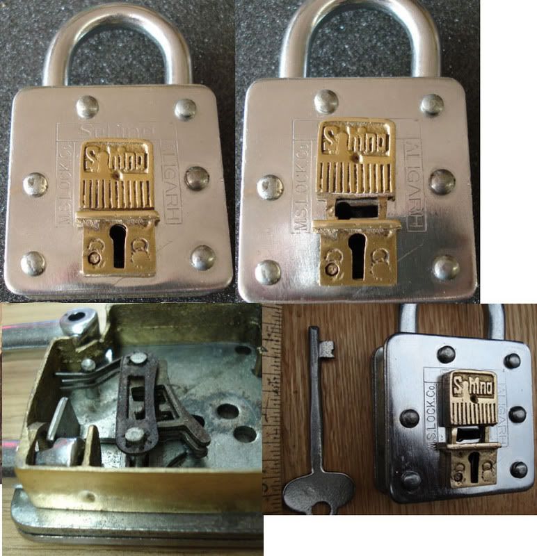

Came across this Padlock in the shop the other day. A customer brought it in to have a key made.
It has M.S. Lock Co., Sohina, Aligarh written on the front. It has a very unique feature, a false keyhole, as seen in the top left pic, where if a key were used in this keyhole, the lock will not open.
There's a button on the left side of this false keyhole that opens the spring loaded cover showing the true keyhole, second pic.
The locking mechanism is a three lever design. The key can be seen in the last pic. Not very intricate in this case. Guess that's why a false keyhole was used to make manipulation more difficult.
The lock needed disassembly when the spring loaded keyhole cover broke off (not by me :wink: ) while attempting the making of the first key. Otherwise we would have never disassembled this lock.

Postby I Pik U » 19 Nov 2006 12:27
How did you disassemble it?
It was disassembled by drilling the rivets in the centres on the backside. Then for reassembly, the original rivets were used; a hole dilled part way down the centre and re-rivted using slightly smaller rivets.
When I first saw how this was assembled, I had my reserves on taking it apart. It was done by a colleague, and he did a fine job. The front still looks the same and the backside has slightly different heads showing.

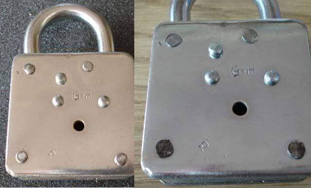

Postby I Pik U » 22 Nov 2006 21:56
Here is the before and after of the backside:
