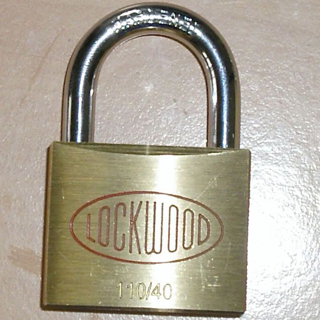

Yesterday I was in a grocery shop and I saw a Lockwood lock which was on sale. It was only like $8 Australian so I got it. I think Lockwood is an Australian brand or it has a different name in America because I haven't seen anything about any Lockwood lock on this site and in Australia almost every lock on a house, school or even some business is a Lockwood lock.
Well anyways, here is the lock
I am almost 100% sure it has at least one security pin because when I try to rake it the plug turns but then it stops. Then If I lower the tension and just keep jiggling the pick inside the lock sometimes it opens.

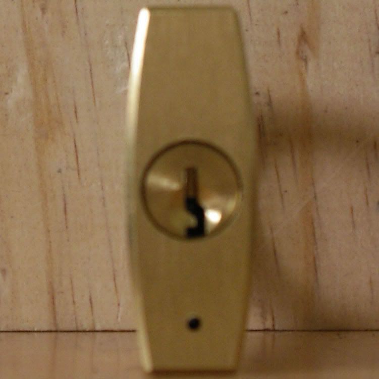

Here is the key way

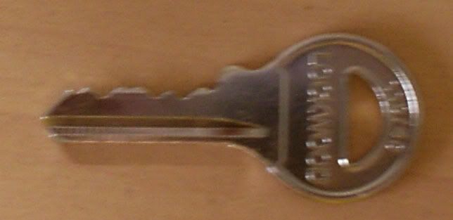

And here is the key
And onto my question. What does that little hole do on the bottom of the lock? It must have a purpose right? Because I really want to open this up to see if it does have security pins.

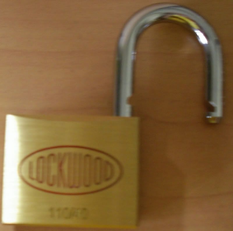

The key only turns 1 way (clock wise) and there is nothing under neath the shackle when its open.

The lockwood is a Australian lock i believe but has been seen elsewhere as most locks are,
They are on site here and there,
The small hole is to allow any water out of the lock,

Ohh and thanks for telling me what that little hole does.

by lockjaw » 6 Dec 2006 22:00
Wow! Another Australian!
I've contacted Lockwood (the manufacturing plant and customer service) and I've asked three locksmiths about the Lockwood 110 and 120 range. I was told by all sources that there are no security pins in any of the Lockwood branded padlock range. Do any Australians know anything about this?
Like you, I too thought they must have at least one security pin because they misbehave when picked. But it appears that they are pinned with regular pins.
The 110 and 120 range are not servicebale/rekeyable so you can't (non-destructively) open them up to verify their pinning.
If you look on the side of the lock you will see faint outlines of a series of small circles (you may need to polish the surface to make these visible). This is where the pins were inserted during manufacture. The holes are plugged with brass. I've been intending to try this for some time (but the drill press is packed away), you can center punch and then drill out these plugs. You will have to be conservative with the drill press so you don't drill into the spring and driver pin. Once drilled you can remove the pins and springs and settle the matter once and for all!
If you have the tools, skills and materials you could create a recess/cover for the pin holes so you can add, remove and shuffle pins for training purposes. I'm yet to do this so don't ask me how.  Any ideas would be appreciated (I'm not sure if Illisuion's method of creating a rekeyable padlock will work on these heavy brass padlocks).

Although I am still convinced there is at least one security pin so I think that drilling it out would be a cool thing to try. The only thing is on the side of my lock I cant see the marks you are talking about. I know what to look for but I can't see them. So how do you think I should polish it so they become more visible?
I would just try and sand it and stuff but the last time I did that to a padlock this is what happened. Before I sanded I could see the marks but they weren't very clear. so I sanded it which made it very shiny and smooth but then all the marks disappeared and there is nothing there anymore... Just shiny brass. So I would rather not ruin my chance of doing drilling it out on my 110/40.
So can you please verify how you would polish it up.
I know what you mean, it all 'blended' into the padlock. So can you please verify how you would polish it up.
I would sand it only with the finest 'wet and dry' or I would use 'Brasso' and a cloth. Try Brasso in preference to 'wet and dry'.

by globallockytoo » 7 Dec 2006 0:12
The lockwood 110/40 padlock comes from their import range, otherwise known in the industry as "Hong Kong Lockwood".
Their is a huge range of these padlocks from very small to very large. Lockwood Australia was originally owned by Ogden Industries, before being bought out by Assa-Abloy. They are now part of the Assa-Abloy Asia-Pacific group.
