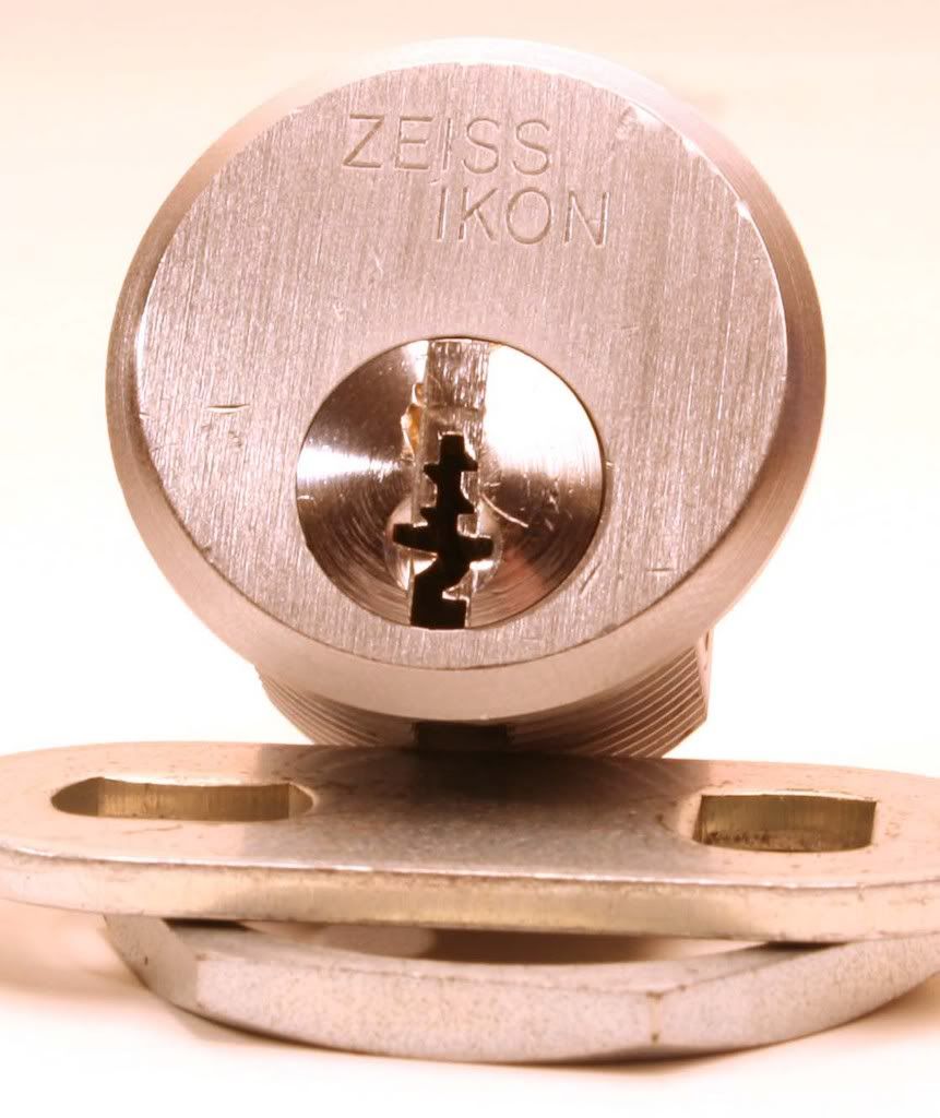

I have viewed the video posted on blackbag and decided to break down some of these locks I have if they are more than just a standard 5 or 6 pin tumbler system. This lock is the zeiss ikon lock. I know how to pronounce the model but have no idea how to spell it so I will not embarrass my self trying.
Anyhow, here are some pics of the lock broke down.
Keyway shot to show warding etc,

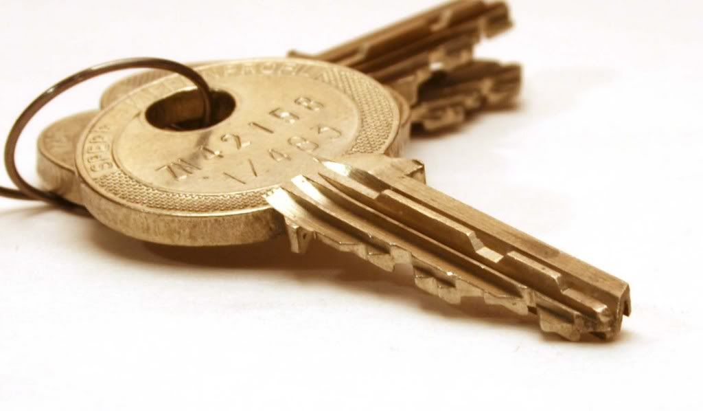

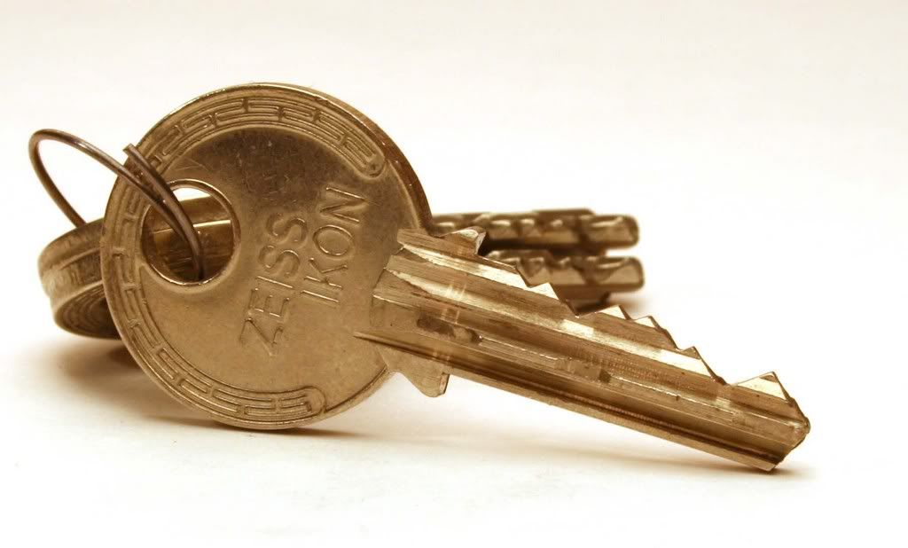

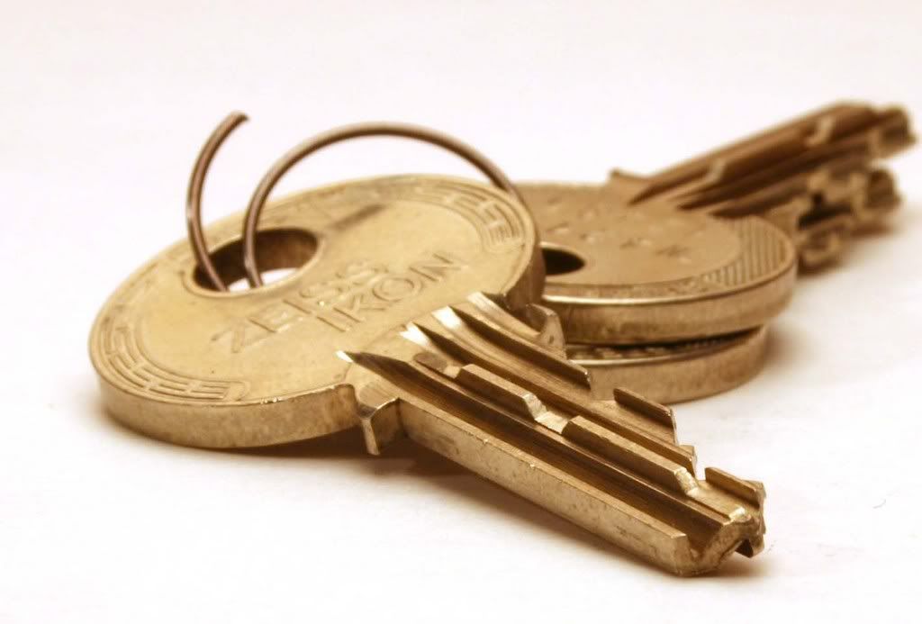

Key shots, displaying the keying and side keying,
http://img.photobucket.com/albums/v375/ ... sikon5.jpg
http://img.photobucket.com/albums/v375/ ... sikon6.jpg
http://img.photobucket.com/albums/v375/ ... sikon7.jpg

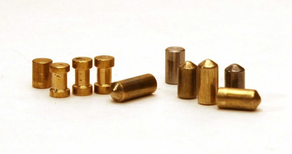

Here is a picture of the standard keypins,
http://img.photobucket.com/albums/v375/ ... sikon4.jpg

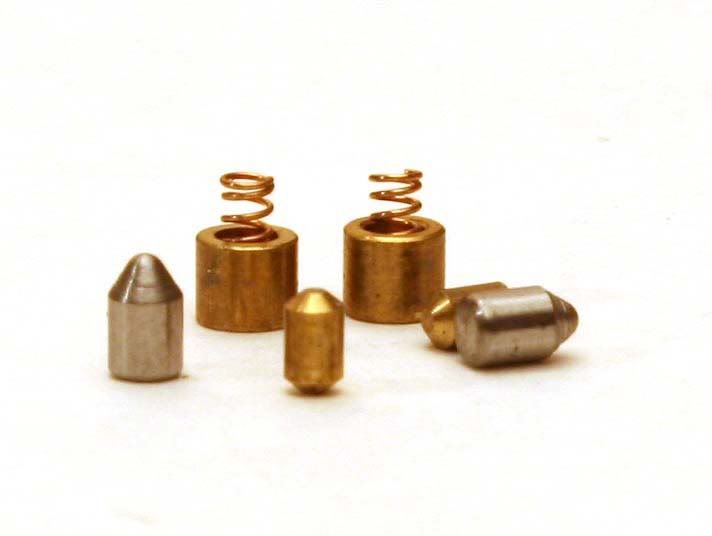

Here is a picture showing the coded sidepins and the inactive sidepins. The small diameter pins are the coded "top" pins and the large diameter top pins with springs interact with these. The larger diameter pins go into the plug point out. These if pressed out will lock into a sidebar type groove on each side of the shell.
http://img.photobucket.com/albums/v375/ ... sikon3.jpg

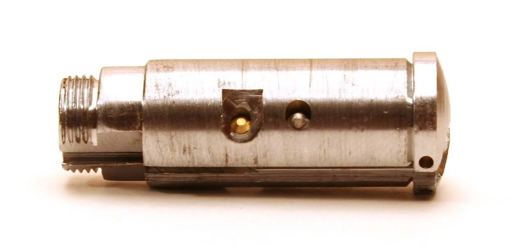

Here is a picture of both active and inactive sidepins in the plug.
http://img.photobucket.com/albums/v375/ ... sikon2.jpg
The lock is what I consider middle run on picking difficulty. The active sidepins can be a real pain to deal with though if they bind when a spool is in middle of being picked but will not bind before the extra rotation allowed by the spool.
Hope that makes sense, it is difficult to explain the situations you may run into on the lock unless you understand how spool pins affect picking.

I have picked this lock, as TOOOL US returned home with a sort of grab bag of Han Fey's locks.
I think this one may have been lacking something, though, as I popped it in under a minute. Same warding and all. I should open it up to have a look...
Postby zeke79 » 14 Dec 2006 9:17
It may not be lacking anything schuyler. As we all know, some locks are easier to pick than others.
IF you do take it apart, remember that the active sidepins are located on the same centerline just almost 180 degrees opposite each other. This can make getting both of the active "top" pins in a bit difficult at times. You will also need a hollow follower which I know some do not have on hand.
