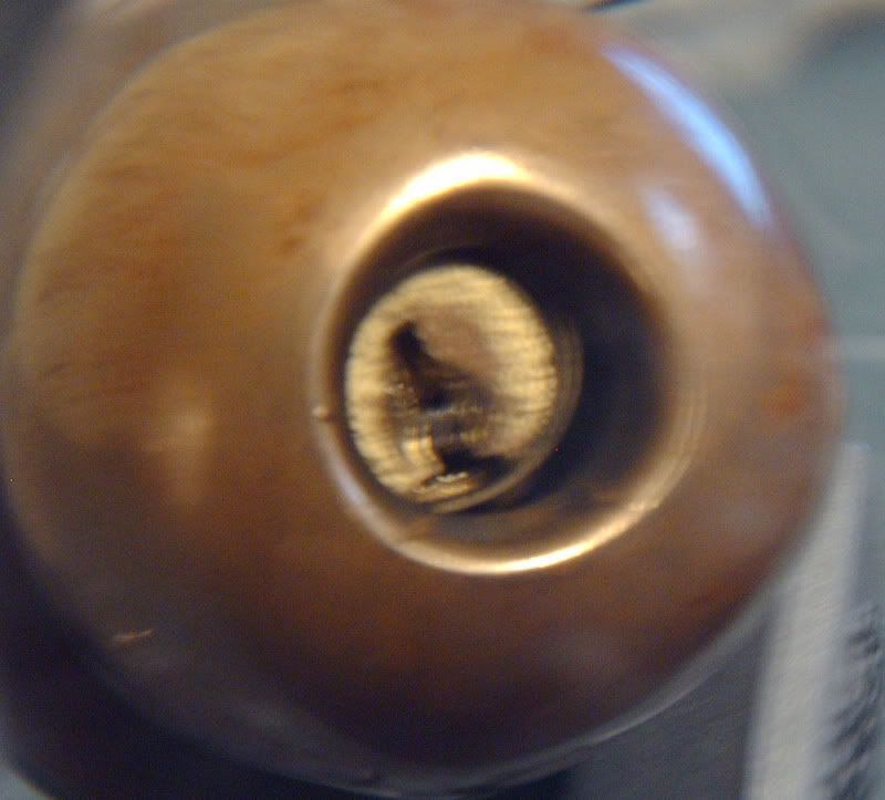

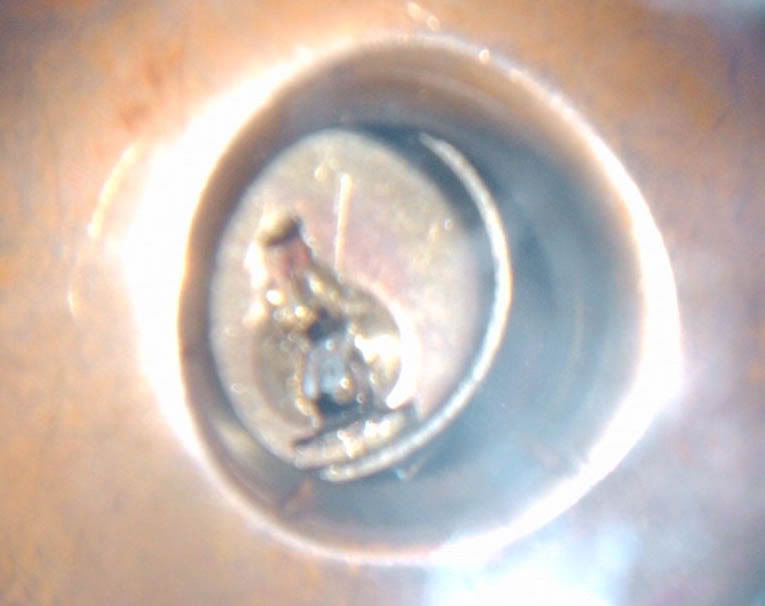

I have a very old Falcon commercial knob lock I'm trying to repair. Someone attempted to break in and drove a nail in the keyway. It's broke off flush with the keyway and appears to be drove in about 1/4 to 3/8 of an inch. It's right at the bottom of the pins.

Can you grab us a pic of the nail in the keyway?
Advice will depend on size of nail versus the keyway and depth of the nail, a pic would give me enough help to give you some solutions,
Postby jimb » 7 Jan 2007 11:18
This is the best I can do with my camera. It has a KW1 keyway.

Postby UWSDWF » 7 Jan 2007 11:21
it looks to be KIK take the handle off, take out the cylinder and then try to push it out

Postby raimundo » 7 Jan 2007 11:46
the nail may have spread the plug, in that case, you will be looking for spare parts to replace the cylinder with another of the same manufacture. Often if its about antique locks, the building will have other samples of the lock in a place where its less important, and you can get parts from one of these. Beyond that, just get to know a guy who works at the local metal scrap yard, and tell him of your interest in old locks, you may get him to salvage some for you. Getting a nail out will be hard, especially to do it without further damage to the plug, you might try heat, to expand the thing and then while its hot try to move the nail a bit with a sharp point like a solder pick. if you can move the nail at all, that means that you got some movement off the point where it was jammed, if you get oil into the plug while the nail has moved a bit, that oil can penetrate to the places where the two metals had previously had raw contact, the oil should help to prevent reestablishing that raw metal contact, with a layer of slippery

Postby raimundo » 7 Jan 2007 13:11

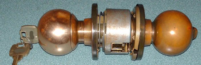

From the photo,the knob appears to be one of those heavy cast bronze ones which would indicate that the lock is a heavy duty industrial one, which should explain the price of replacement, particularily if replacement requires the same piece of hardware

Postby unbreakable » 7 Jan 2007 13:58

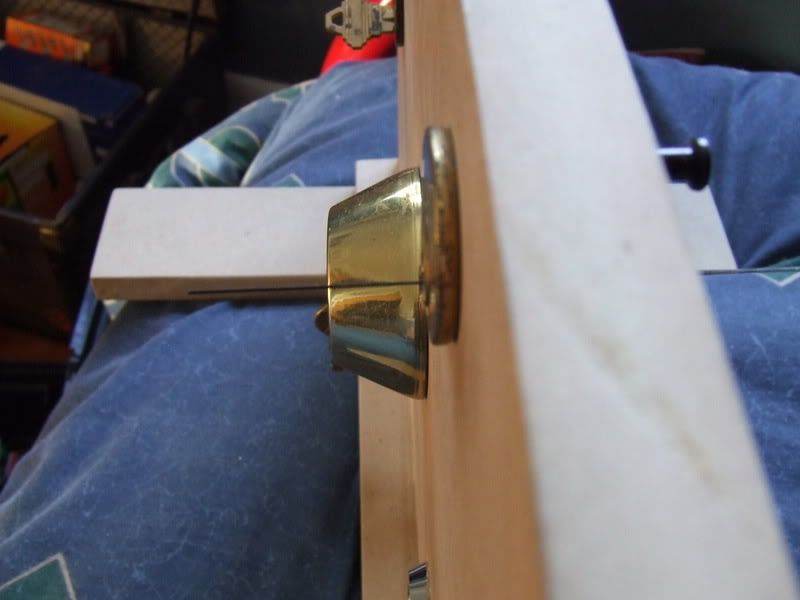

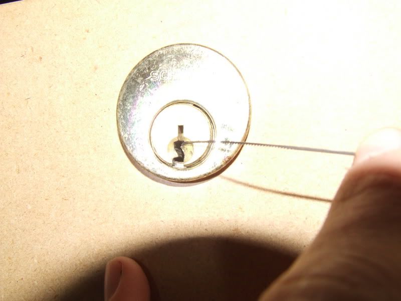

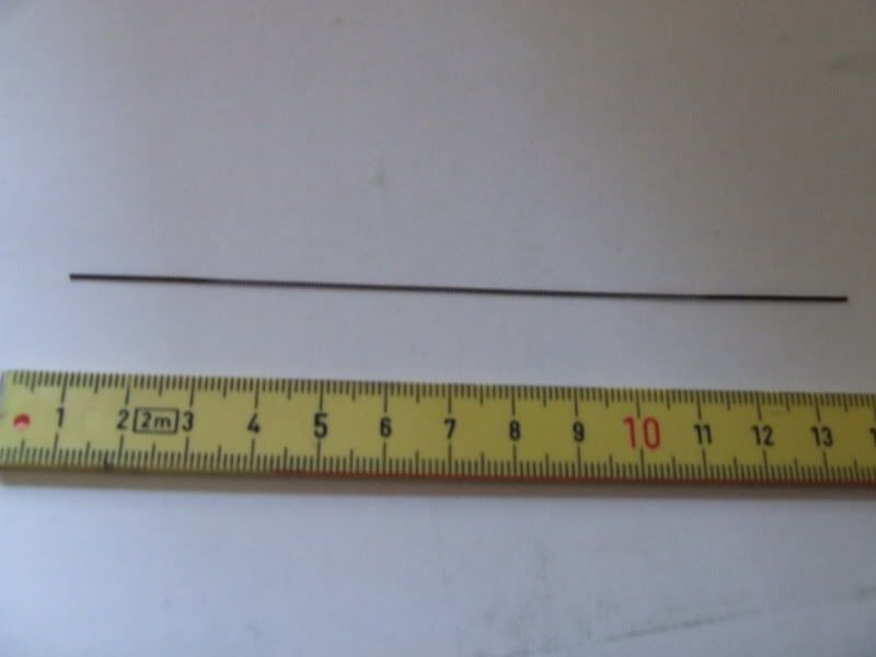

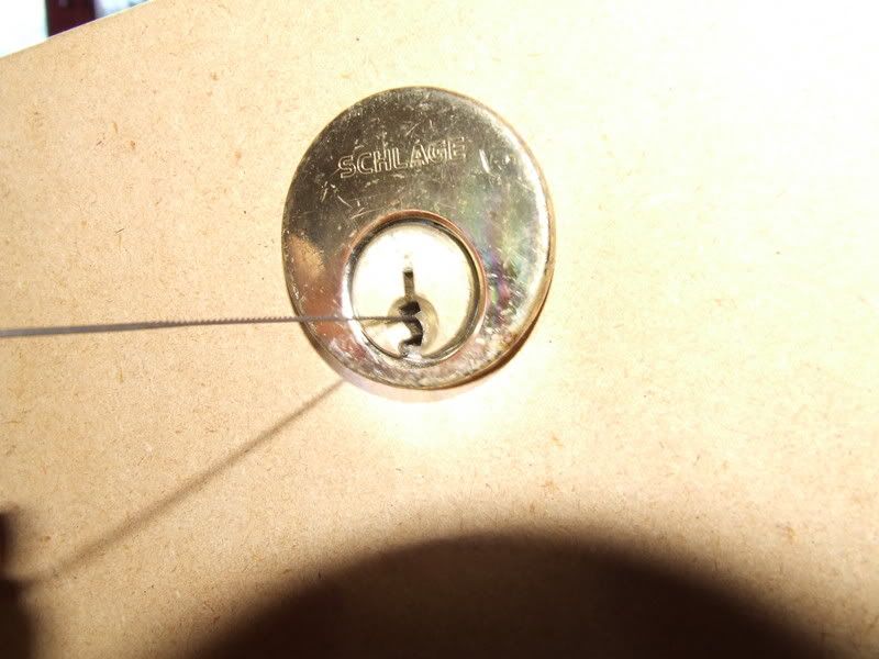

If you really want, you could saw it out with a jewlers saw
It has ample room in a Schlage keyway(SC1). This is assuming you can thread it all the way through the lock.

Postby unjust » 7 Jan 2007 16:14
if the nail is only a fraction of an inch in, i would go for drilling it out.
take a metal bit ~75% the diameter of the nail, i.e. 1/8" nail, 3/64" bit. center the nail by using a jewlers/hobby size 60~65ish bit in a collet hand drill for .5 mm to get a centered hole.
a drop of oil on the tip of the drill bit, and medium speed. too fast adn you could kick out of the steel of the nail, and damage the softer metal.
after you've gotten in far enough pressure from the plug should collapse the nail around the drill bit or it will begin to spin, and you can just pull it out.
from there, if the plug is deformed a gentle vise may be able to skish it happier, or replace it.

Postby jimb » 7 Jan 2007 18:10
Fixed :!: Thanks for all the ideas.
raimundo - I liked the idea of heat but had no way to heat it up. I did use you lubrication idea and used wd40 as I thought it might get into the tight spots. I then took a short hook that I had made from street sweeper bristol and a pair of vice grips. I slid the short hook in above the pins and hooked the nail and yanked it out. I was the able to pick it to get it apart and repin it for a new key.
zeke79 - Drilling was a possibility, but I was afraid I might not find a replacement for it.
unbreakable - The saw blades were a great idea but I did not have access to the back of the cylinder. I even have these blades in my tool box and they sometimes make good key extractors by using them on the side of the key.
unjust - I had thought about drilling out just the nail but didn't trust my aim :lol:
