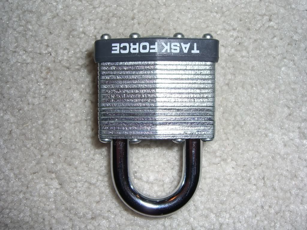

I have been able to pick many Master Locks, but unable to pick a lock with the brand Task Force. I don't know what the exact name of the lock is but it says 40mm on the bottom. Does anyone know how to pick this lock?

Postby hurri » 13 Jan 2007 2:33
post some pictures if you can...never heared of Task force..

Postby Bud Wiser » 13 Jan 2007 12:26
If I'm not mistaken, TF is just another really cheaply made lock. SOme times the real cheap ones can be difficult because they are so poorly made. Often you will have trouble opening them even with the key :)

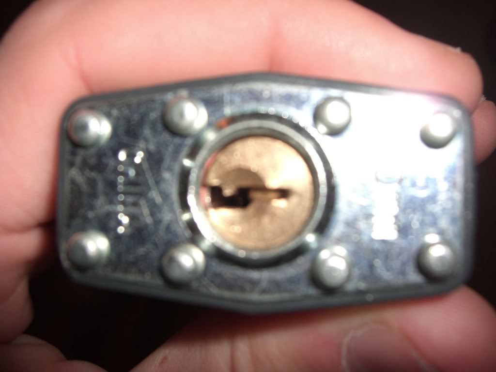

Postby raimundo » 13 Jan 2007 14:20
does it say china? try to hook the locking dog reach right through the keyway out the back of the plug :P if it doesnt work or ya break something, I never told you to do it.

Postby zerg49 » 21 Jan 2007 15:36
one of my friends had one and I picked it, inisde it feels like a master #3 but thats just me... good luck

Postby raimundo » 22 Jan 2007 12:45
look for info on picking spool pins, the cheap chinese locks do have them, and why not, they couldn't be difficult to make. or just try raking it with light and intermittent tension
Postby docdredd » 25 Jan 2007 2:18
yeah i know it that was the first lock i ever picked. absolute junk. i think i paid 1.50 for mine. half an ounce of tension and a little probing = click.
they are really cheaply made and like what was posted before they can be a booger to open with a key sometimes :D just keep at it
