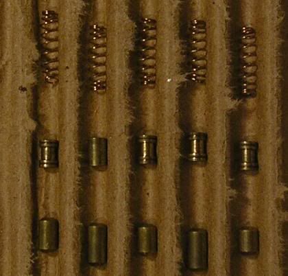

Ever once in a while I see someone (newb or experienced user) ask what and if there are security pins in a certain lock, I'm going to try and start a thread that could address some of the questions about locks with security pins and their locations. I'll start with pictures I have of an American lock clone I bought at Ace Hardware. Despite the generic Ace (hardware) brand name, this lock had quite a few security pins inside it. Including those cool serrated-spool pin hybrids.
The pins, left most stack is the first one the key touches when it goes in the lock:

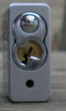

The keyway, I couldn't seem to get a clear picture of this. Note how much it looks like the American keyway, same means of removing the cylinder too:

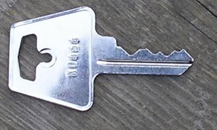

The key, same head as the American key:

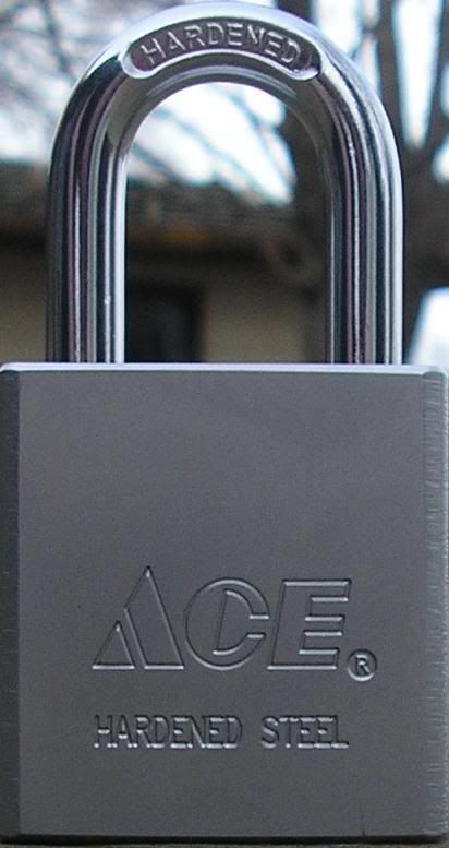

The body, just so you know what lock I'm talking about:

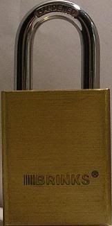

I did the same thing for my Brinks Rekeyable too, here ya go.

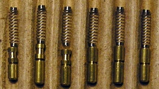

The pins, regular bottom pins, but four of the five were the cool hybrids:
The body, a lot of people already know what this one looks like:

Brinks Shrouded, 6 pins, 5 spoorated top pins and 5 serrated bottom pins.
