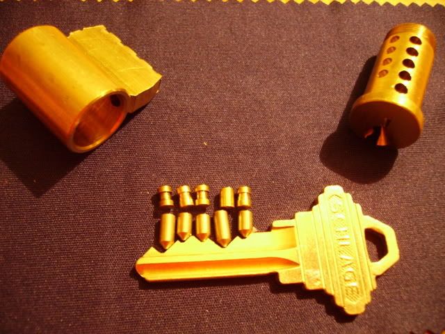

Postby PrimalFuture » 19 Feb 2007 0:37
I purchased a Schlage deadbolt from Home Depot not too long ago. Took it apart and from what I can see, it DOES have mushroom security pins, in addition to 2 spools. The mushrooms can be seen on the number 2 and 5 pins in the photo of my Schlage below.
PrimalFuture
Posts: 7
Joined: 3 Feb 2007 1:00
Postby PrimalFuture » 19 Feb 2007 0:46
p.s. The model number of my Schlage with the 2 mushrooms and 2 spools reads B360N V 609.

Postby mercurial » 19 Feb 2007 7:17
PrimalFuture wrote:I purchased a Schlage deadbolt from Home Depot not too long ago. Took it apart and from what I can see, it DOES have mushroom security pins, in addition to 2 spools. The mushrooms can be seen on the number 2 and 5 pins in the photo of my Schlage below.
I stand corrected, as far as my assertion regarding factory-pinned Schage's containing spools as opposed to mushrooms.
