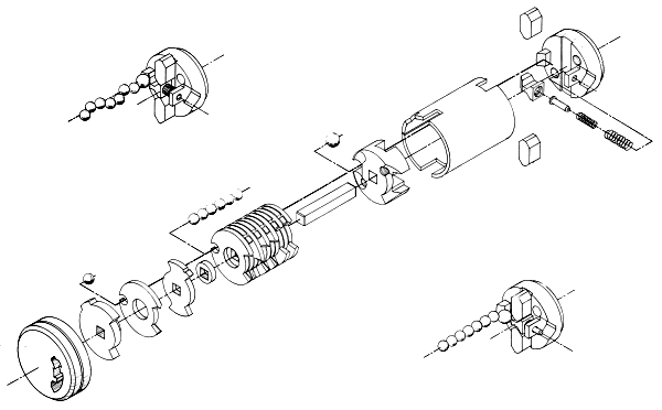

Postby n2oah » 2 Jun 2007 17:55
I honestly don't have a lot of info on them, I just saw one on eBay once and I stumbled upon a schematic. Here's all I can give you:

Postby mh » 3 Jun 2007 1:28
Great, thanks a lot! :D
Are you sure that's "Norman"? Somehow I think it could have been "Neiman" (from France, now Valeo), but I didn't find much about them, either...

mh wrote:Great, thanks a lot! :D
Thanks,
mh
Honestly, I can't remember. It was on an eBay auction, and all I can really recall is that it was a brown mortise cylinder that went for a high price.

Postby mh » 3 Jun 2007 11:05
globallockytoo wrote:By not incorporating a return bar....and allowing the discs to remain stationary when withdrawing the key, would likely make the cylinder, very low security and super easy to pick/or impression
Well, of course I mean a system where the discs are returned - just without the use of a return bar...
Some locks do that with control surfaces on the key, like DOM Diamant or that Norman lock shown above,
but I wonder if the Abloy style locks (where the discs are positioned while the key is turned) have been designed w/o return bars.

Postby mh » 3 Jun 2007 23:43
That "Norman" (or Neiman?) lock would have the key slot on the outer edge of the cylinder. I'm quite sure I've seen that before, just can't remember.
Anyway - any other examples of "true" Abloy-style locks, bi-directional, without return bar?
Thanks a lot for your help,
mh
