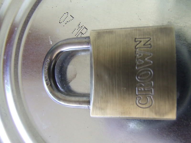

Well, I needed something to do well I was cooking hot dogs, so I decided to disassemble a brass padlock, using only a bar-b-que, a pair of tongs, some tin foil, and a coffee can filled with ice water.
*note* this will only work on brass padlocks with the stamped pin covers. Do not try this on laminated or removeable core padlocks.

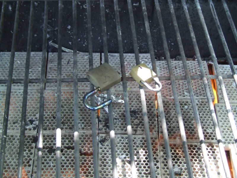

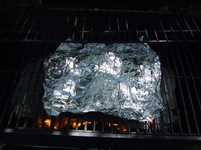

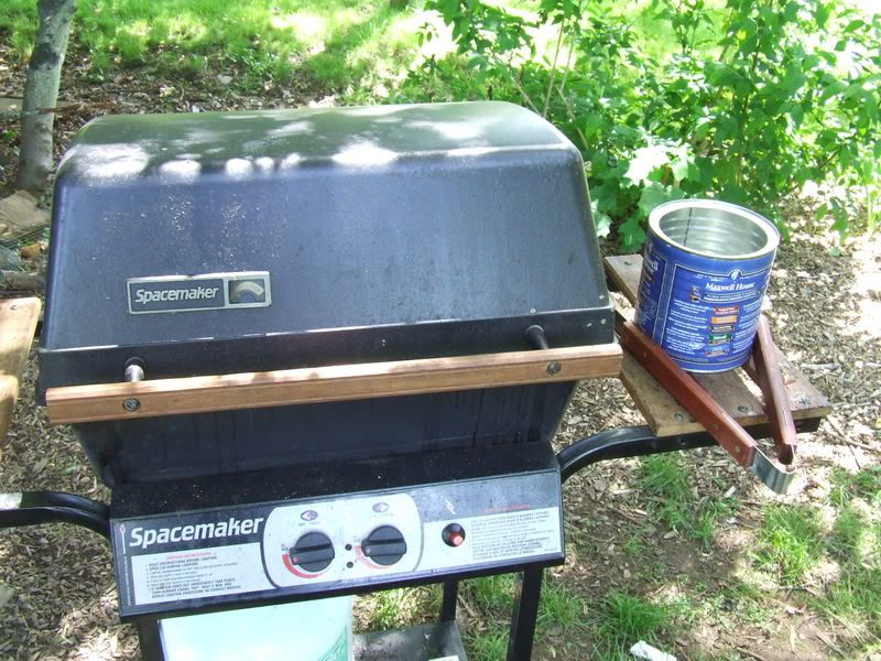

Get your bar-b-que running on high, and place your coffee can and tongs nearby.

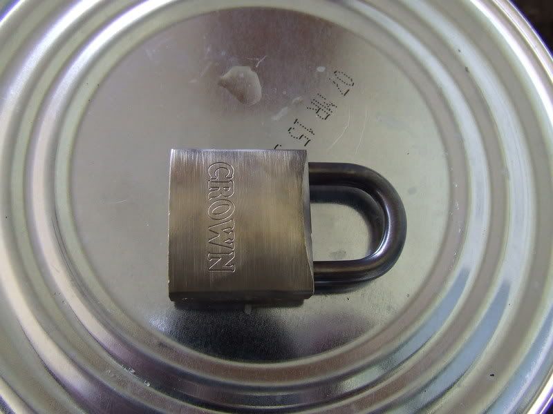

Place your locks on the grill.
Proceed to cover them in tinfoil shiny side down, making a "dome" above the lock. Use at least 3 layers of tinfoil.

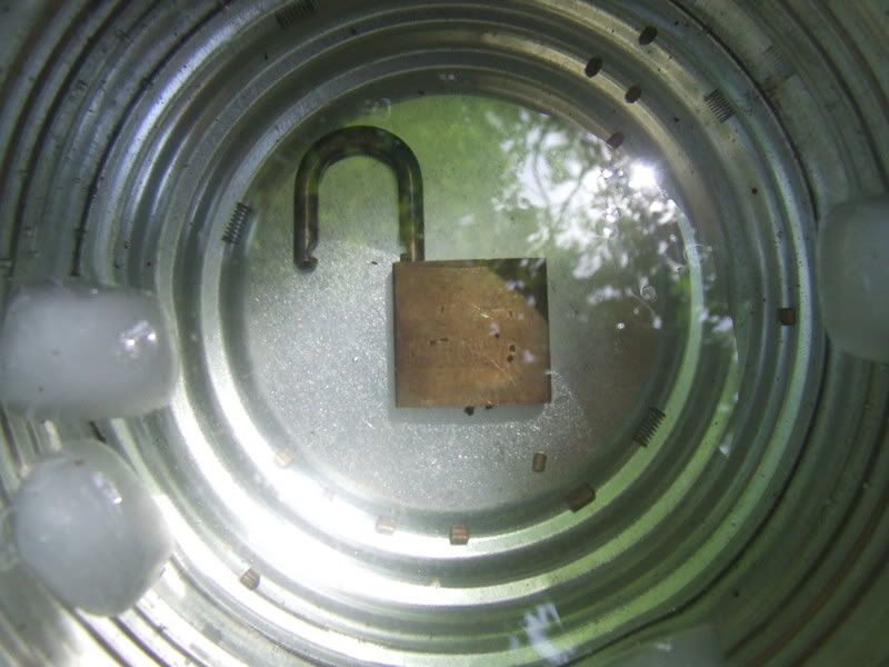

Now bake the locks for 10-15 minutes. Remove the foil, and pick up the lock with the tongs and immediately plunge it into the ice water.
The covers will blast off, followed by the springs and pins.

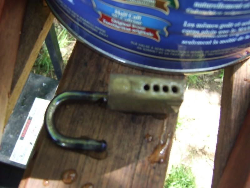

Here you can see where the pin covers were.

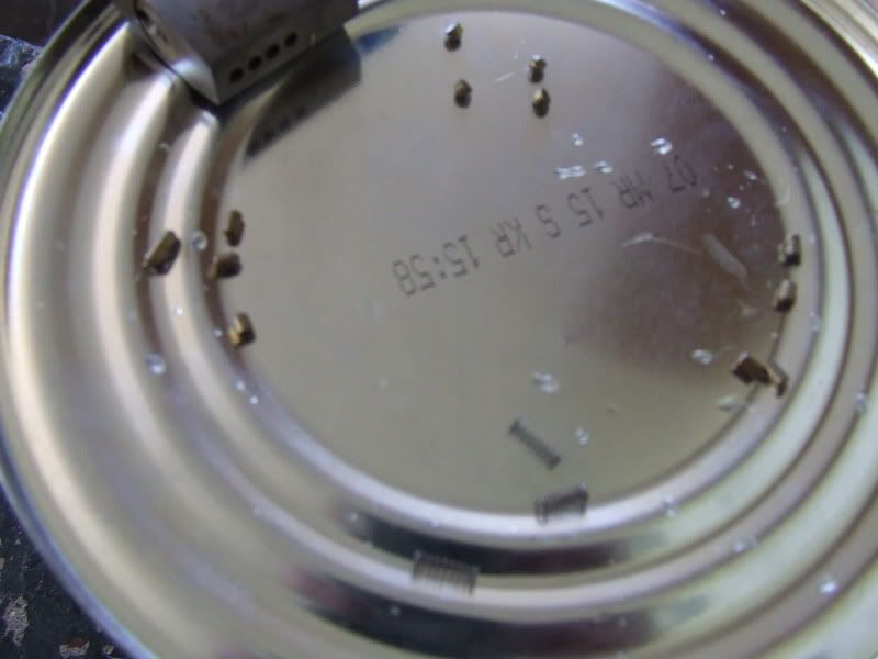

Next, drain the water and remove all the pins. Be careful not to lose any. Here I rearranged the pins and springs. Springs are one pile, covers are another, and top and bottom springs are each their own pile.

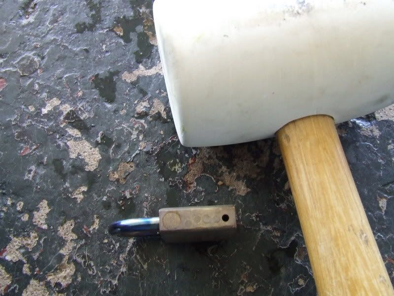

Replace all but the first pin cover using a rubber mallet. Do not put springs or pins into any of these three holes. In the remaining hole, put the bottom, top and spring back in, and tap on the pin cover.

1. your rubber hammer is white, im jealous, I only have a black one.

raimundo- you should see my other hammer. Its white speckled black from hammering closed a tremclad paint lid 8) :lol: :lol:
As for the other two covers- one for the locking dog and one for the pin to limit the cylinder rotation, neiter blew off. My only explanation would be that the 4 pin covers were being forced out by the springs...
