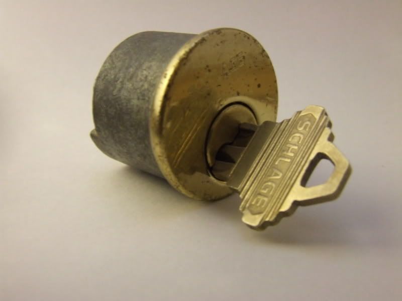

Here, it looks normal, it could be used like this, no problem

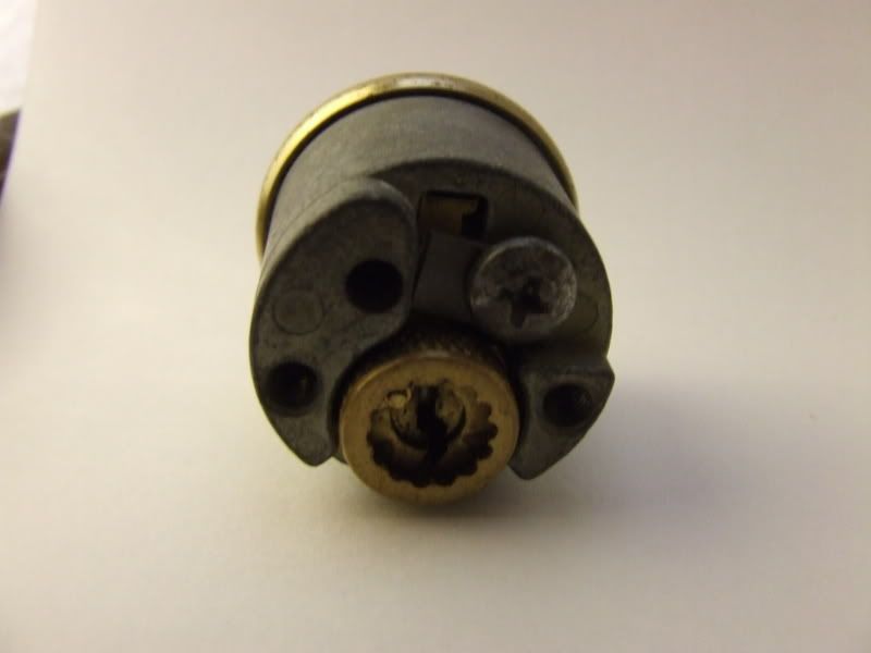

This is the back end of it, the screw holds the KIK in the housing.

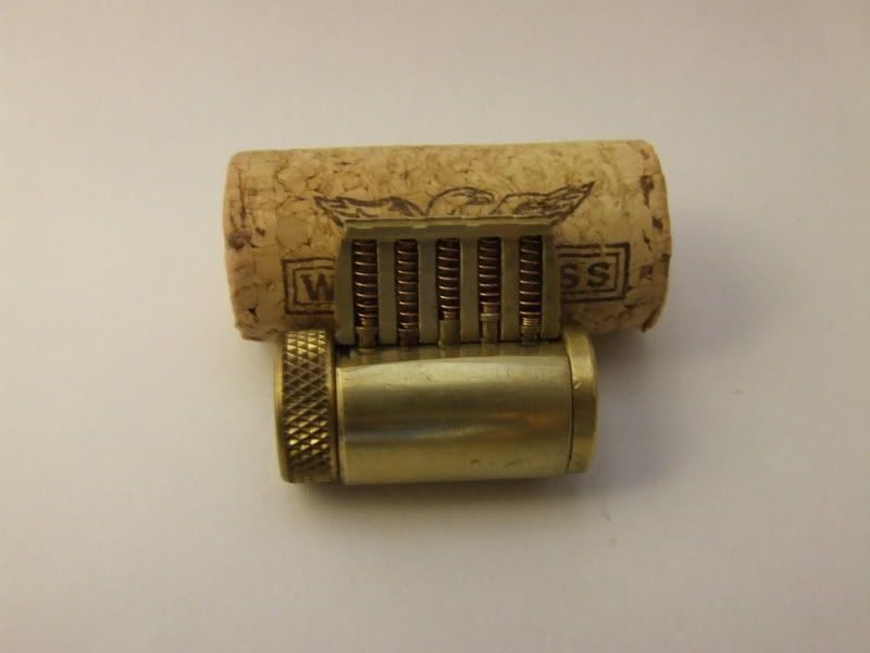

KIK removed, showing pins with no key inserted. There are 4 spools and 3 serrated key pins.

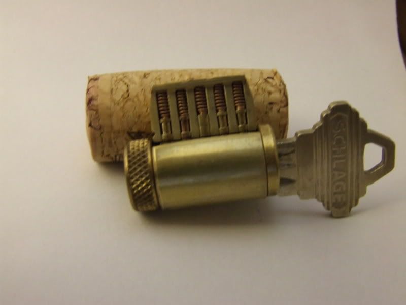

Correct key inserted, and plug rotated.

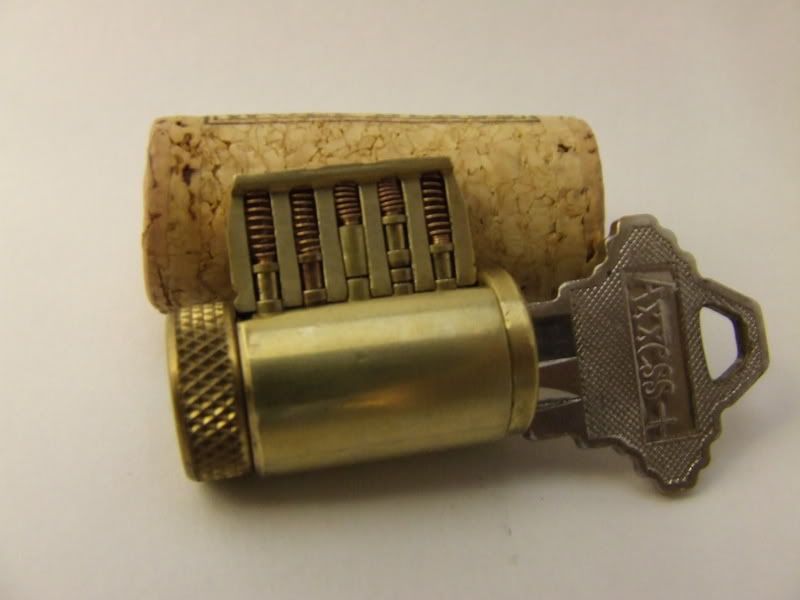

Wrong key inserted, notice the one serrated key pin.

ummm you do notice that theres a cork on that lock... or is it just me?
Postby unbreakable » 20 Jul 2007 18:38
UWSDWF wrote:ummm you do notice that theres a cork on that lock... or is it just me?
Yeah, thats in case I drop it in the toilet AGAIN, so this time I won't have to go hand fishing :evil:

meh, I just find the cork looks good and props the lock up easily for photos.
