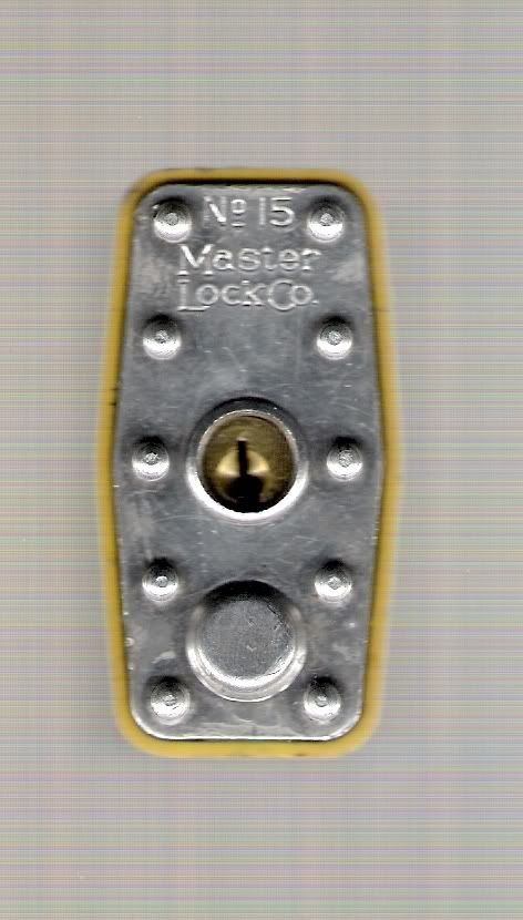

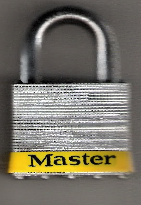

Postby Iceberg_Slim » 21 Aug 2007 13:16
take a picture of it, what does it look like, anything maybe differnet from other models?

Postby tmaxx258 » 21 Aug 2007 14:30
Iceberg_Slim wrote:take a picture of it, what does it look like, anything maybe differnet from other models?
It has 5 pins,10 rivets,the shakel is thicker(boron aloy 5/16" shackel),the width is 2 1/2".
There is not really much of a differance exept that it is bigger and has 5 pins.

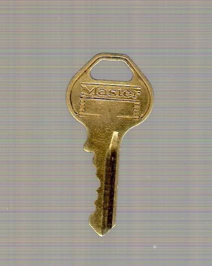

Postby RangerF150 » 21 Aug 2007 14:36
Master locks are easy, that said it might be a high low cut on the key.
Have a look at the key if there is a high cut next to a low cut that could be the cause of your problems.

Postby tmaxx258 » 21 Aug 2007 15:11
