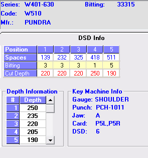

I am looking for a Key Code for Office Specialty (Pundra 5 wafer) number W510. I don't have a code software program. I am hoping that someone can give the key code. If posible I would like the code in space and depth info in either inches or mm. I do not have a code machine so I will have to cut the key by hand.
I know it is asking alot but I would really appricate it. I am trying to fix a cabionet lock for a friend.

3 3 3 1 5

Postby UWSDWF » 13 Oct 2007 18:23
spaces:
.140 .232 .325 .417 .510
depths:
.250 .235 .220 .205 .190
